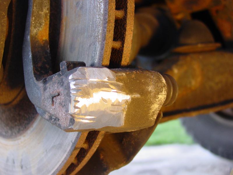

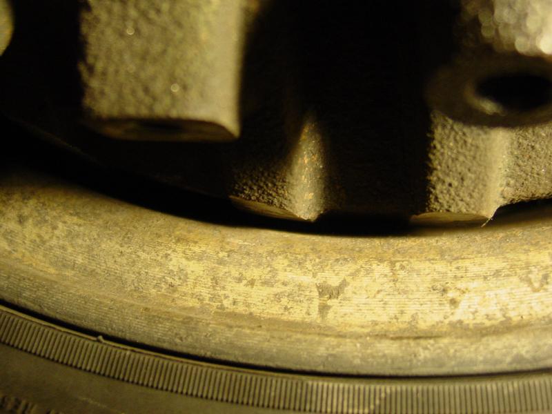

    The first issue is the dust shield, and there are 2 solutions-the four bolts that hold it to the knuckle are indexed, or rotated, about 3/4" compared to the Sport, and it interferes with the lower caliper bracket, so it either needs to be cut with tin snips or the four holes redrilled to line it up correctly. Easy fix. The second issue is more time consuming-with the stock 15" wheels the caliper body makes contact with the inside of the wheel, preventing it from seating flush with the hub. You can either switch to 16" wheels, or do some grinding, as I did. I have pictures to illustrate, but it is a minimal amount of grinding, and it all fits great now.
    Anytime you alter or modify brake components it should be done with care and common sense-mucking about with brakes can cause injury or death. So, with that in mind, let me hasten to state that the grinding involved is minimal, and no where near the piston bores or other sensitive areas. I took off less than 1/8" on the outer corners of the bracket and caliper itself, and am confident nothing has been compromised or made unsafe-the calipers bodies are pretty stout, as you can see in the accompanying photos.
    So, with that said, this looks like a practical, affordable solution to weak stock brakes, made worse by installing larger tires.
    Here are the photos-rotors.jpgbrackets.jpgmontero rotor.jpgbracket grind.jpgclearance.jpg

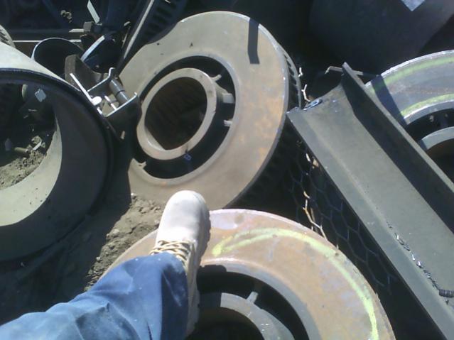

    3,846
    I did find these rotors in the junk yard today. I didn't have a tape measure so I put my foot on one of them for sizing. I think only one is needed to stop the truck.
    Does anybody know if this conversion was finished?
