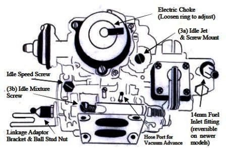

    Pics for Weber thread. : these are to help anyone with there install.
    Will be adding more .

    That setup looks different from what I'll end up with ... my throttle cable hooks right up like stock.
  22. #197
    There are a number of throttle configurations with Weber carbs. They have clockwise, counter clockwise, opposing side and opposing end throttle linkages. We have a write up on model identification codes and what they mean.
