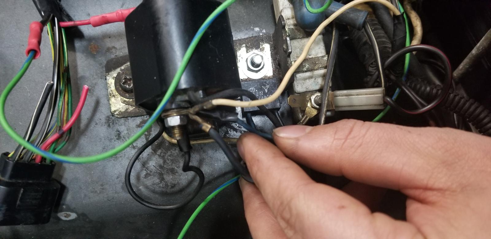

    6. How does my electric choke connection look? Acceptable? it is a keyed power source, but just want to make sure with you guys its OK and if there isnt a better place to hook it up.

  6. #281
    So far everything looks fine.
