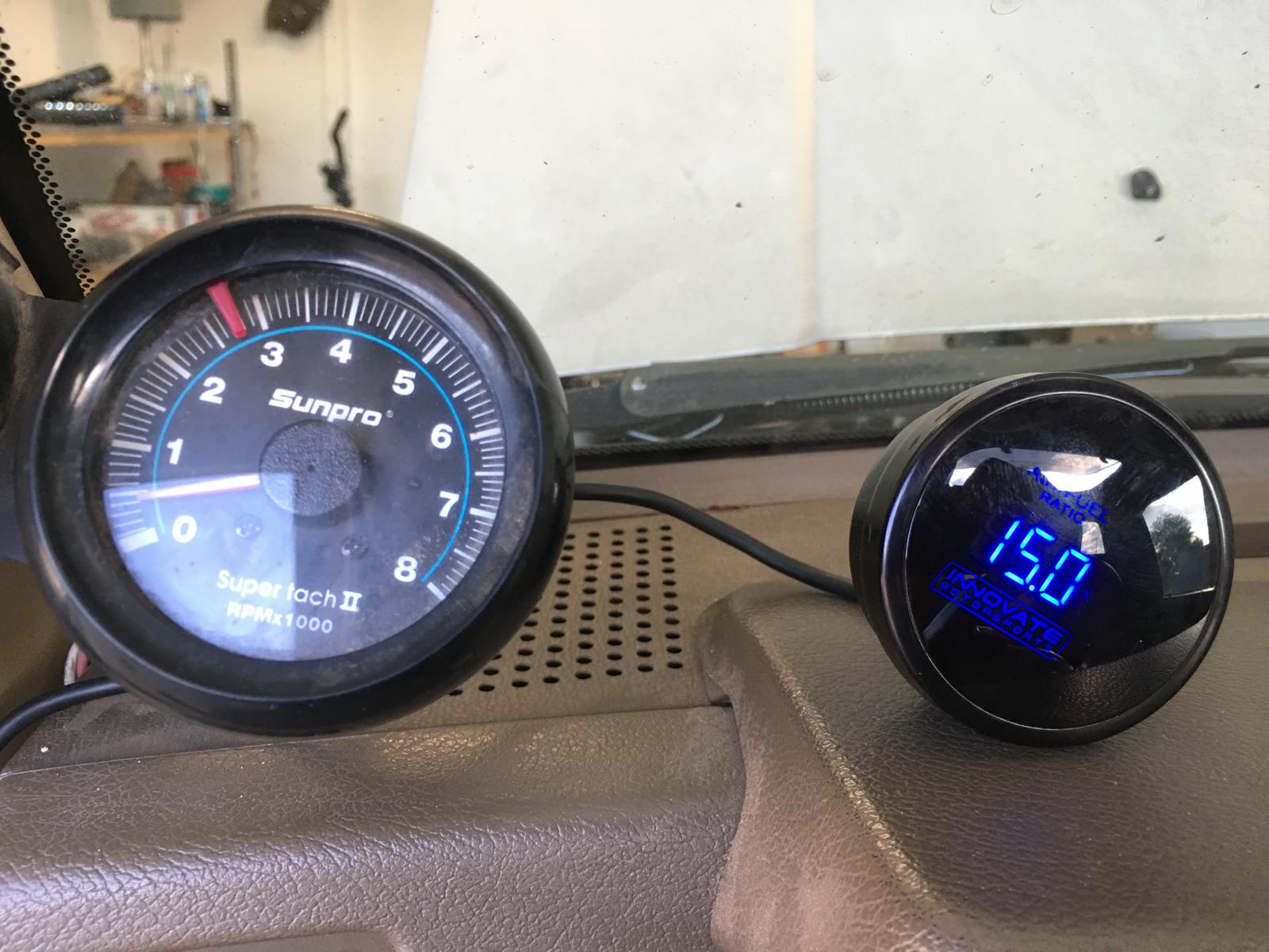

    So I tried keeping the choke plate open and it still cranks but does not start. I know I still need to fix the psi problem but does that mean the floating is not the problem? Could it be electrical and if so.. what?
