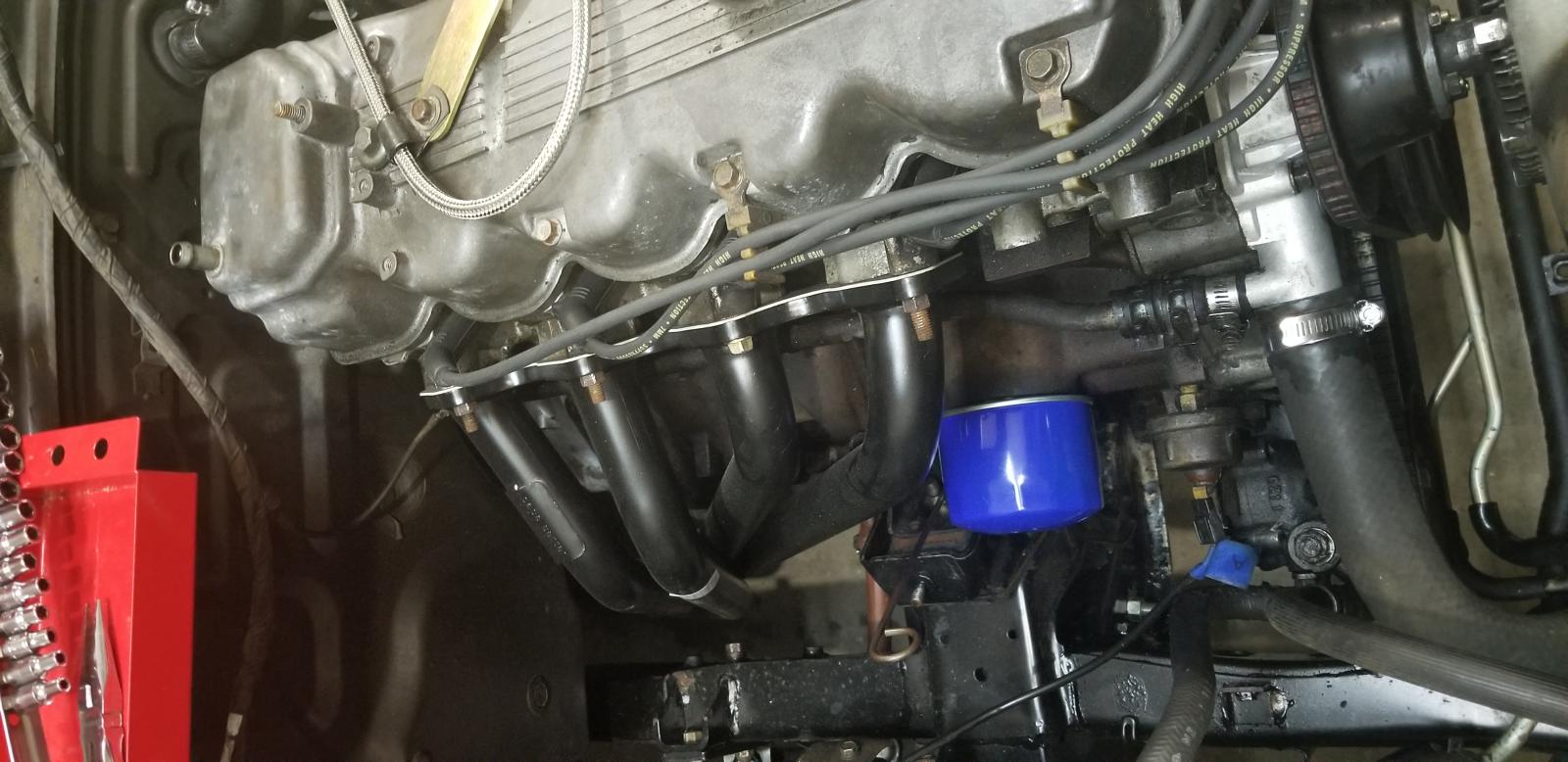

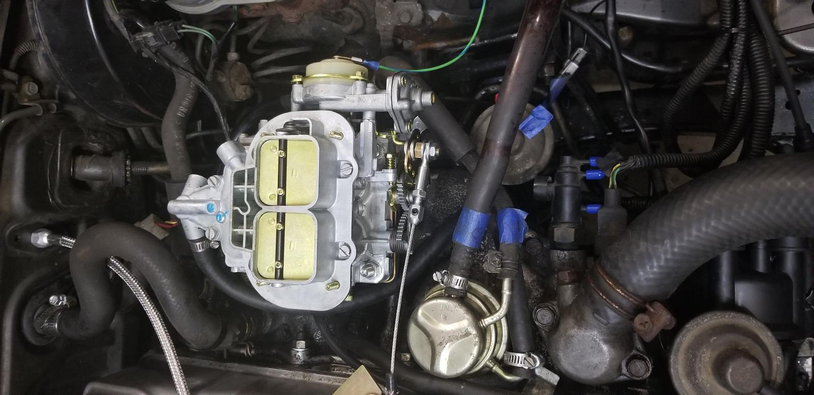

    This is my first post and I am having trouble. The truck just cranks but won't start after installing the weber carb.
    Background:
    Removed engine and trans to replace rear main seal. When I placed the motor back in I replace the alternator, water pump, radiator, spark plug wires, rotor and rotor cap.
    Upgrades:
    Pace setter headers
    Weber carb
    After hooking everything up and refilling all fluids, I turned the key and it was going to start. I waited for about 5 min and now it just cranks but wont start. Carb is getting fuel, tested the spark with a screwdriver, tested secondary for the coil. Vacuum system has been removed except the line for vac advance from the distributor. I am all out of ideas and could use some help. I attached pictures if that helps. This is my first time doing this so maybe there is something I am missing or not seeing.
  18. #268
    09-30-2012
    394
    Vanessa, Ontario
    1989 Dodge Power Ram 50
    If you didn't put a fuel pressure regulator in and you are using the OEM fuel pump it might be possible that you are flooding the motor. I think the OEM pump puts out around 8 psi and the Weber only wants 3. It may be overpowering the float and pouring fuel into the throttle body. Try holding the choke plate open with a screwdriver and depress the pedal some then try starting it again. If you have to keep your foot on the accelerator to keep it running chances are it's too rich and you will need a fuel pressure regulator.

    You may have a bigger problem - is it a legit Weber carb? If it's a 'licensed copy' (read as 'bad knock-off) you will never get this thing to run right. Tips on installing a Weber carb - used a high volume, low pressure electric pump (don't try to regulate the mechanical factory pump as it will eventually kill it) and ensure it's a genuine unit. Plug the coolant port under the carb to eliminate possible coolant bypass issues as well.

    Have you tried starting it after a shot of starting fluid down the carb throat? If it starts and runs for a moment, that reduces the chance the problem is electrical. There may be air in the fuel lines that the fuel pump can't overcome at cranking speed. A couple of starting fluid starts might be enough to get fuel flowing properly if that's the problem. I used to have a Weber and I had to use starting fluid to get the truck running if it sat for more than 3-4 days.

    When I got it all together, I sprayed carb cleaner in the carb and that is when and only when it wanted to start. I will try the fuel pressure idea and let you guys know the outcome. I also need to plug the coolant as well. Thank you

    So I tried keeping the choke plate open and it still cranks but does not start. I know I still need to fix the psi problem but does that mean the floating is not the problem? Could it be electrical and if so.. what?

    Carb cleaner is flammable but it still might be too wet. Get a starting fluid which is extremely combustible (ethyl-ether). Spray a shot of it into the carb and see if it starts and runs 2-3 seconds. If it still won’t start, remove the plugs. Note if the plugs are very wet or fouled. Dry, clean and gap each plug. Check that each plug is getting current and fires with a bright arc. If the plugs spark as expected, install the plugs and wires. Double check the plug wires at the cap to be sure the firing order is correct. If you didn’t remove or move the distributor earlier and everything checks out fine to this point, try another shot of starting fluid. Then crank it over with the throttle open slightly. It should start and run for a few seconds.

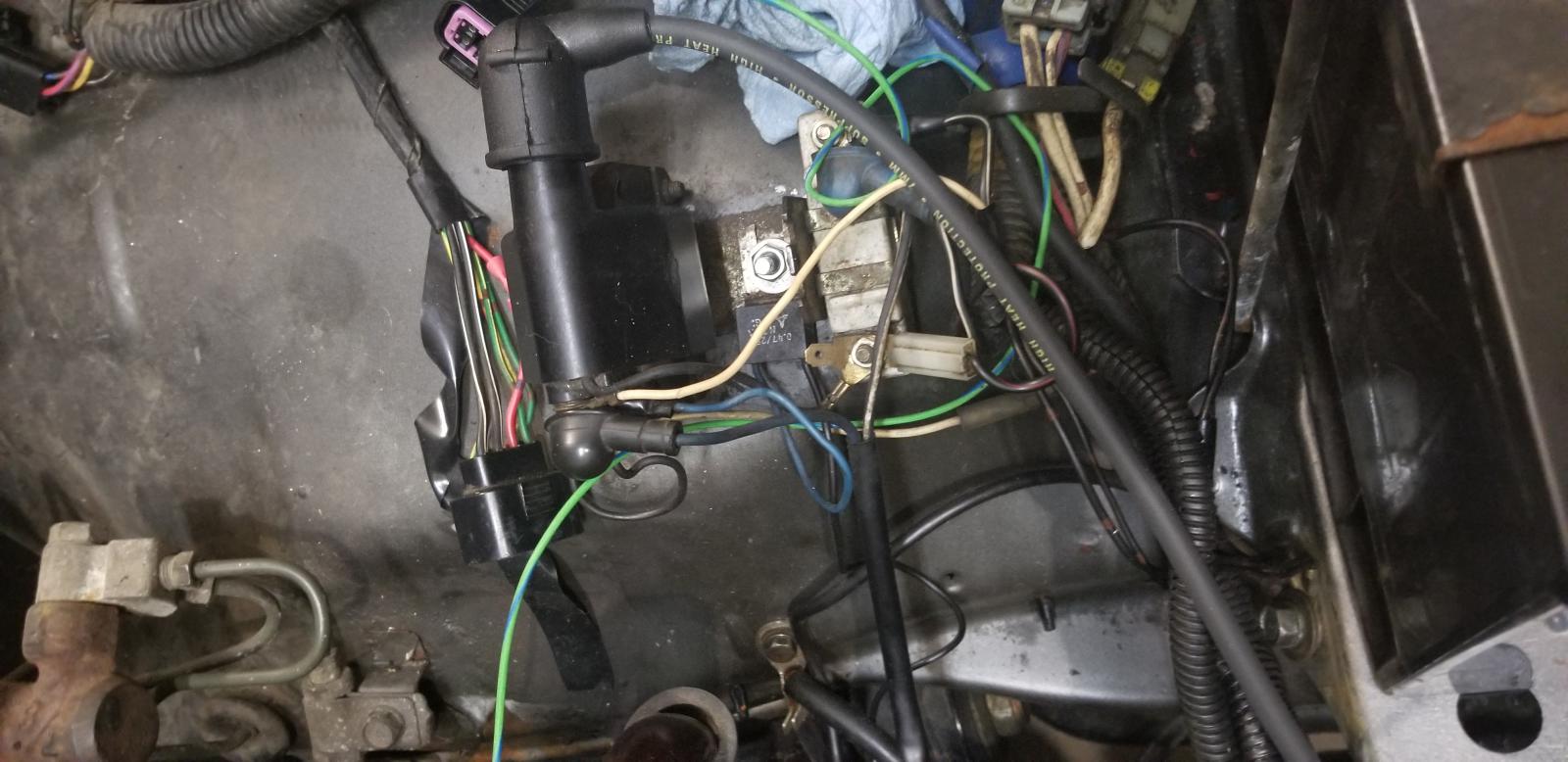

    So I tried the starter fluid and the timing. Still the same. I was doing some other testing and noticed the spark seems weak. Could that be a problem and if so, what could cause it? Also, I know the vacuum system is obsolete but from looking at wiring diagrams the gray control box on the drivers side has like 2 ignition wires that hook into it. Do I need to have that hooked up?
