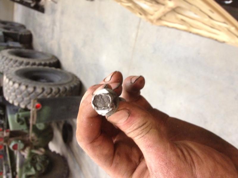

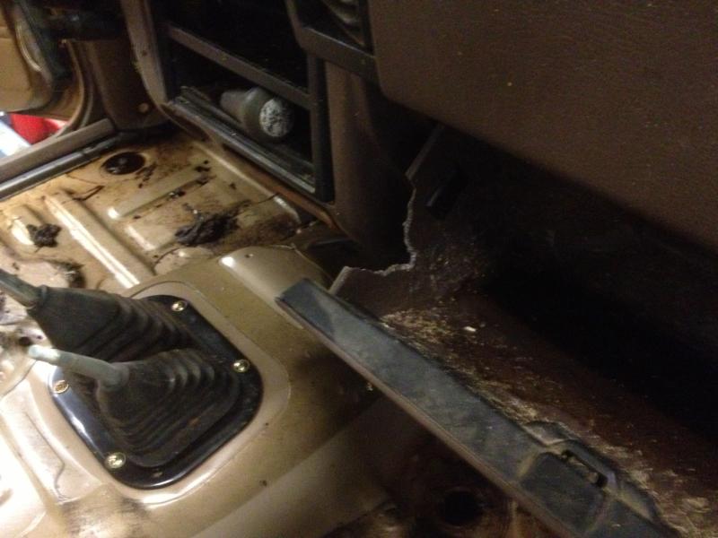

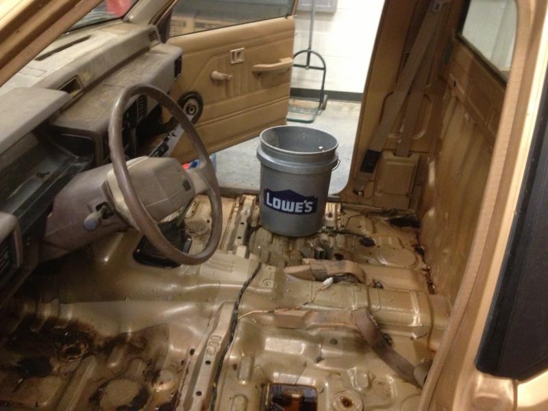

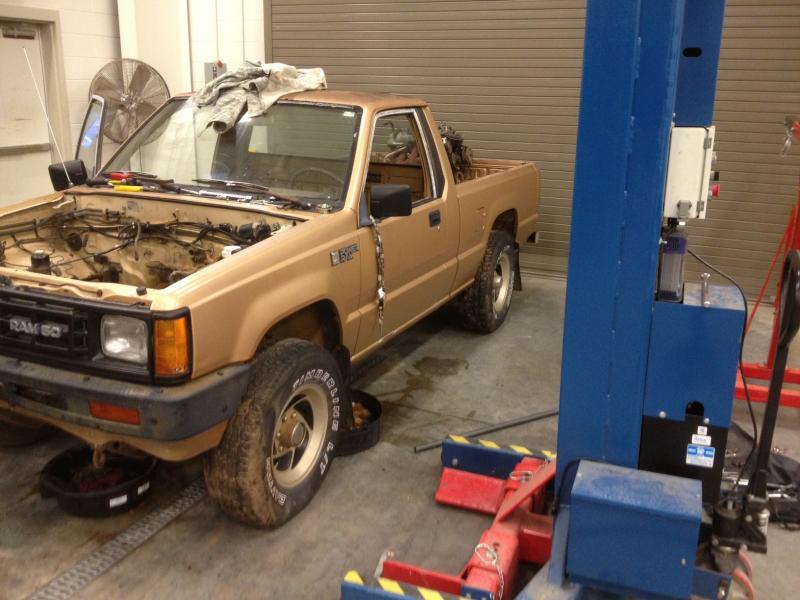

    bolt.jpg This is the top left tranny/motor bolt that stripped. Had to file it down to a 10mm heat it and bust a few knuckles....truck.jpginterior.jpg after the rat eviction glove box.jpgthey even ate part of the darn glove box??? cbt.jpg Im sure you are interested to see what the other truck in the shop was....
    Looks like the rats ate your seats and carpet too looking in that one picture...
    03-23-2013
    18
    Fort Smith, AR
    The rat crap was so thick I was scraping it out with a garden hoe. I had a mound from the ground to the door. Piss saturated the floor and the foam was nearly all gone from the rats hiding it in the ducts. Finally got the smell out and the wife refuses to ride/drive it. **win!**
