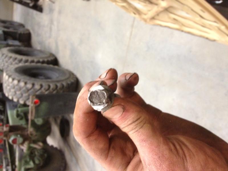

    I rounded a bolt on the daggum top left tranny bolt (up against the firewall) I can't beat a 12 point socket on like I normally would. Any suggestions? Afraid to use heat since it is so close to the carb and has oil all over the engine. The only tools I can get to squeeze in there is an open 14mm wrench and vice grips. I've had it soaking in sea foam but am open to suggestions!

    If you pull the intake manifold carburetor and all and wash the oil off you can heat up that bolt and crack it loose with the vise grips. With the manifold out of the way you may have a bit more room to work.

    Got it finally. Just found a fire extinguisher and kept it handy. Little heat and a few busted knuckles later I was in business. Should put the new motor in sometime next week.

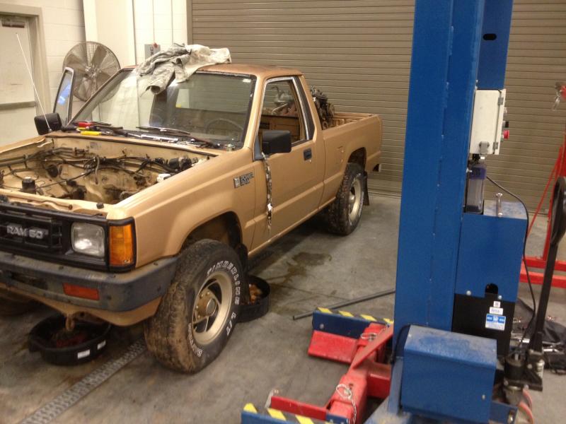

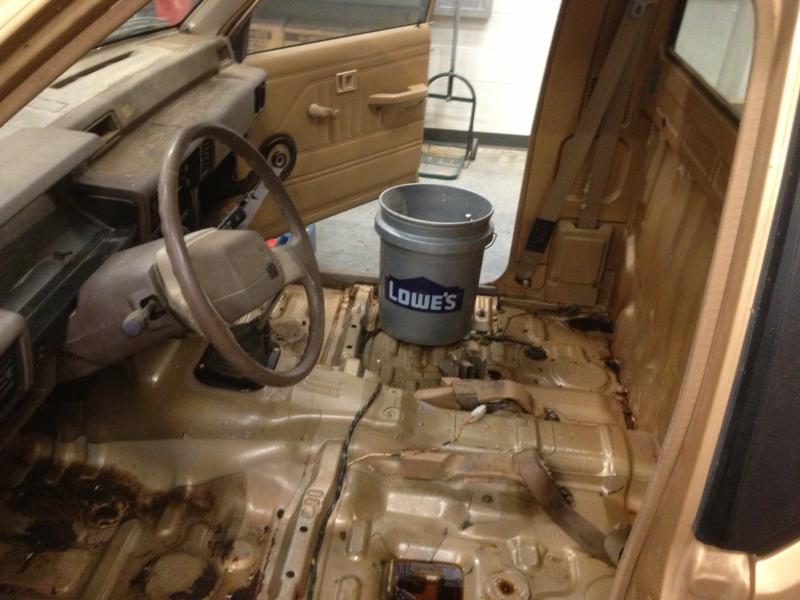

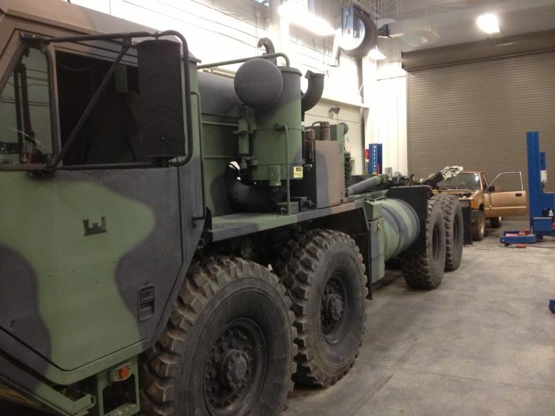

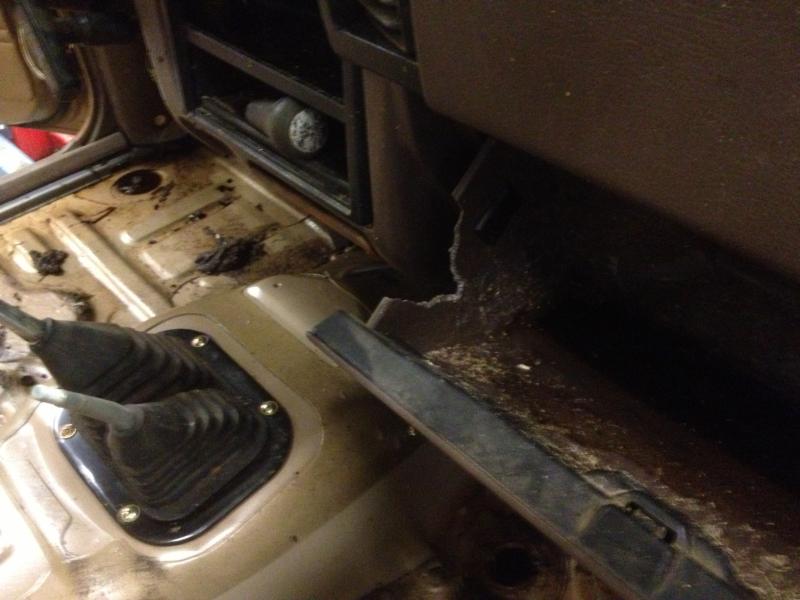

    bolt.jpg This is the top left tranny/motor bolt that stripped. Had to file it down to a 10mm heat it and bust a few knuckles....truck.jpginterior.jpg after the rat eviction glove box.jpgthey even ate part of the darn glove box??? cbt.jpg Im sure you are interested to see what the other truck in the shop was....

    Got everything lined out she is running good (little weaker than the V8 that im used to driving). Just have some small issues to fix like the a/c compressors. I like the compressor and brackets that came out of the donor but will not mount up to my condensor (hoses are different mounting style). The idler arm is out so it has the death wobble at 65mph. Also has a high idle in neutral and im afraid to mess with the carb with all of the horror storys i have read about. I would like to thank everyone that helped me out with some very good information.

    Looks like the rats ate your seats and carpet too looking in that one picture...
    03-23-2013
    18
    Fort Smith, AR
    The rat crap was so thick I was scraping it out with a garden hoe. I had a mound from the ground to the door. Piss saturated the floor and the foam was nearly all gone from the rats hiding it in the ducts. Finally got the smell out and the wife refuses to ride/drive it. **win!**
