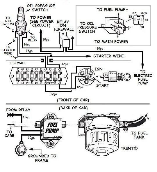

    Quote Originally Posted by greenteagod View Post
    I'd just do the wiring based on that website you linked. It seems to be a lot easier diagram to follow. Just add a T to where the original sensor was so you can put the old dummy light sensor and the new switch in place right there and wire like this
    Attachment 5380
    Just hooked my own up followed this diagram. Worked fine on the first try. Tried following the other diagrams and they weren't dumbed down enough for me. Either way, works!
