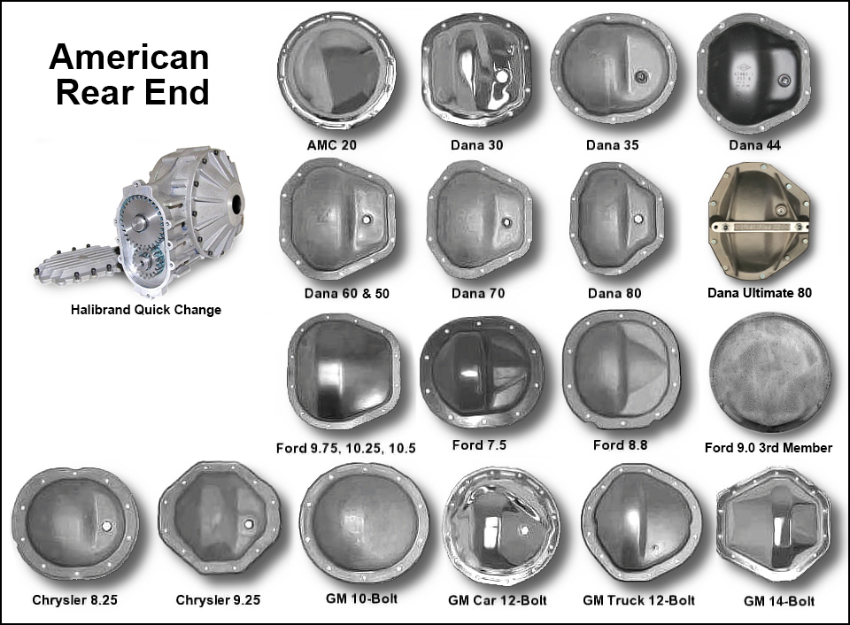

    Some good info here for American Car Owners.
