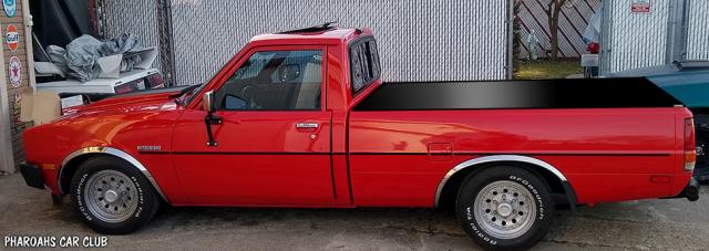

    1986 Mitsubishi Mighty Max Pick Up

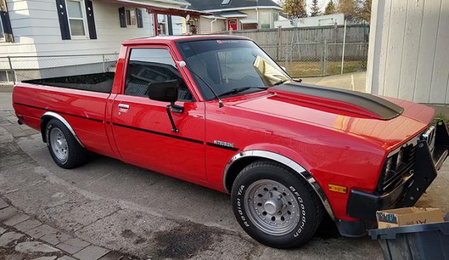

    1986 Mitsubishi Mighty Max ("Mitsy") Repair-Renew-Rebuild-Replace Thread Build

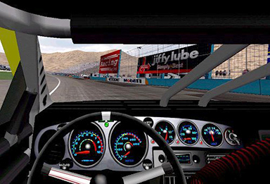

    The Toyota Celica was featured on The Castrol Oil Company & CRAGAR Wheels site a few years back too.
    There also was a Multiplayer Online Racing game called NASCAR Heat,
    quite a few years ago and we created custom mods for the public to the online game community.
    The Celica Mod Game Addition and modeling process.
    http://www.racelinecentral.com/CelicaHeat.html
    This Game Mod was sort of a representation of My Truck and a Camaro Z28 combined into a limo race car.

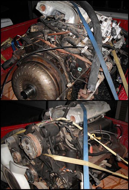

    $500
    Well it looks like we are going to buy another vehicle, 1987 Thunderbird w/302 5.0L. The wife's kid needs money pretty badly and he is going to sell his Tbird to us for a very good price.
    It does have a subtle blown head gasket on one side and has let some water into the oil. It is not being driven and sitting in storage. It has very nice rims and new tires. The black sprayed items on the car need to be resprayed because the paint has been washed down to the coating. The mirrors, trim, and these items will be redone. it has a crack in windshield, but it is just a single line crack that can be fixed later.

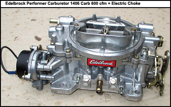

    One thing that is strange to me is the carb that is in place. It looks to have 2 fuel injectors placed on top of it pointing down the barrels. One for each side - primary/secondary. One other thing I noticed is the wheels are 4 lug!? WTF was Ford thinking to put only 4 lugs on a car with a V8.
    The body is in perfect shape with a teal color but needs to be buffed and should come up perfect. Interior is kind of messing, but nothing a can of shampoo won't fix or new seats from wrecking yard. The car has AC and Auto on the column. It is mainly for the wife and we will probably sell her 94 olds achieva as time goes on.

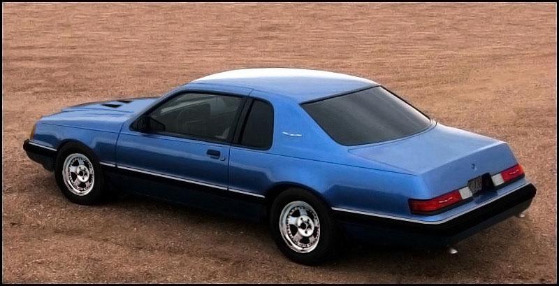

    Here is an example image of an identical TBird, with almost the same exact rims. The paint on the image car is better of course, but we should be able to bring back the paint to about 80% of what is shown in the image.
    We should be picking the car up tomorrow sometime and pulling it into driveway to repair headgasket asap. Pretty excited about this since I have always liked this model Tbird and it should be a fun car to fix up.

    that is a tbi setup from the 80's on that 302 - detroit's answer to fuel injection on the cheap. Run some good fuel injection cleaner, like BG or redline through it to get the crap out of the fuel. Too bad its not the 3.8 SC with the supercharger.

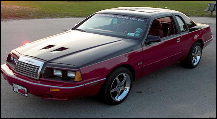

    Correction on year of T-Bird is a 1985 Elan. The prior owner was just storing the car because of the water in oil when I asked about it and he thought it was a 1987, but was wrong. Also the car was built in Lorain, OH. Ford Plant which no longer exist as a manufacturing facility. The place kind of looks depressing with cracking cement and overgrown vegetation everywhere, Reminds me of the city in the movie.."I am Legend".
    I located this Roush version of the T-Bird that really catches the eye. I don't really like the scoop on the hood much and I'm going to go with the Turbo Coupe Naca style instead. The color scheme on the Roush is what I am going to aim for, with maybe a darker upper silver that is shown or also maybe a dark Gold upper body with all the chrome trims changed to black.

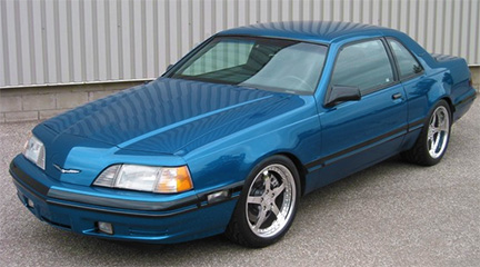

    The blue one above looks like the one I have, same color and parts. Mine has chrome different style rims though, with wider tires.

    The wifey spotted this image and she wants this TBird to be just like the one here. Must have 40 coats of clearcoat on this thing, Oh great.
    Actually I kind of like it too, but I keep hearing this ringing in my head....cha-ching cha-ching. If she wants this paint, she'll have to sell her Olds Achieva to pay for it. Probably.

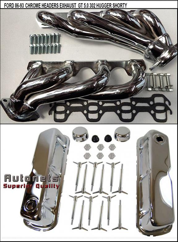

    Restoration Build for 1985 Thunderbird, purchased $500.
    Completed List
    Pull '85 302 Engine, Install 1988 302 V8
    Rebuilt AOD 4 Speed Automatic Transmission
    All New Seals & Hoses

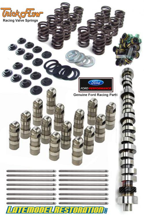

    Ford Racing Roller HO E303 1.6 Cam 1,3,7,2,6,5,4,8
    Ford Racing Hydraulic lifters, Rockers & Push Rods
    Comp Cams Magnum Double Roller Timing Gear Set

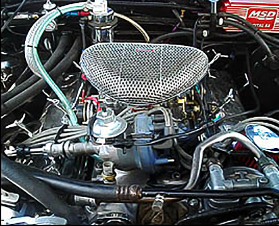

    Edelbrock 1406 600cfm 4bbl Carburetor
    Edelbrock 2121K Performer Intake & kit
    Edelbrock Top Flow Air Cleaner
    Carb Throttle Linkage
    MSD Digital 6A Multispark Ignition
    MSD 8282 Blaster ll Coil
    MSD Pro-Billet Full Race Distributor / New Steel Gear / No Vaccum Advance
    Chrome Valve Covers/T-handles
    Chrome Shorty Style Hugger Headers

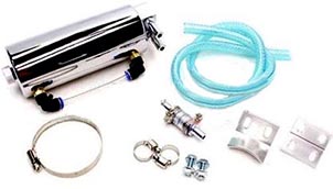

    K&N crank case breather

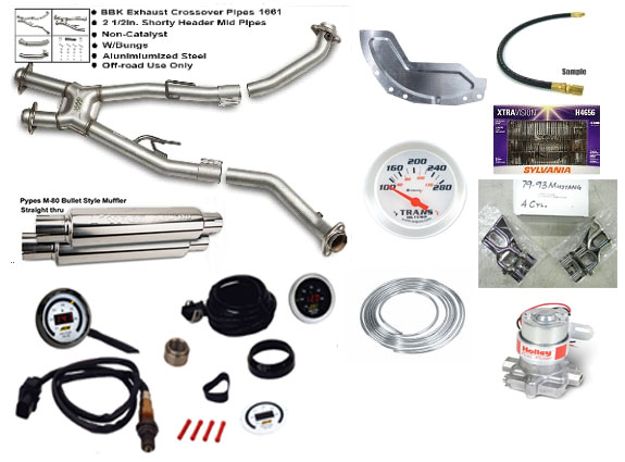

    Duel Stainless Pypes Mufflers & Chrome Tips
    BBK Aluminiumized Duel Exhaust "X" Pipe
    Ford Distributor Rubber Cover Protector
    March Performance Serpentine Underdrive Engine Pulley Kit w/Oversized Alt Pulley.
    FelPro Full Gasket Kit w/One piece Blue Oil Pan Metal Inlaid Rubber Gasket
    Lokar TV kick-down cable
    Lokar Throttle cable
    Lokar Throttle, TV, Cruise control carb Bracket
    B&M AOD Shift Improver / Street Set Installation
    Wix Trany Filter
    Wix Fuel Filter
    Ported heads - exhaust and gasket matched head to header
    Trick Flow Double Valve Spring Complete Set
    Remove and Relap Exhaust & Intake Valves, New guide seals
    Repaint engine bay to black
    Holley Fuel Pressure regulator
    Holley Red Fuel Pump
    Replace all 5/16 vinyl fuel lines to 3/8 aluminum / Removed in tank EFI fuel pump & insert pickup pipe in place
    Goody's Fuel Regulator Pressure Gauge
    Turbo Coupe Naca Hood Scoops
    New Aluminum Heater Core
    Remove Fuel Tank, Flush, Paint, Replace Sock Filter, Remove Tank Pump
    Replaced Dash Speedo Display & Repaired the transmission gear indicator.
    Starter & Solenoid
    KYB Shocks
    Column to Console Shifter Upgrade
    Completed Interior
    Switched column shift to a Mustang HO console shifter
    Wink 5 panel rear view mirror
    Dye Entire interior to Black

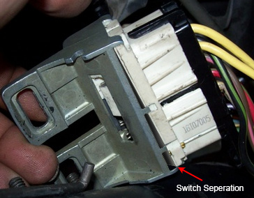

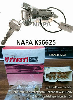

    New electrical column engine start switch & New Key starter switch

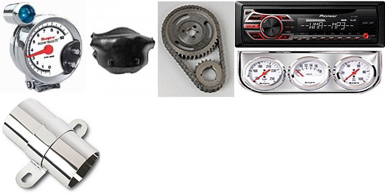

    New Pioneer stereo in dash w/new quad speakers
    New Cougar 3rd Tail Light
    Dash Cover
    New Windshield
    Replace headliner
    Rebuilt both window regulator motors & door lock motors, lubed mechanism.
    Redo upholstery under back window

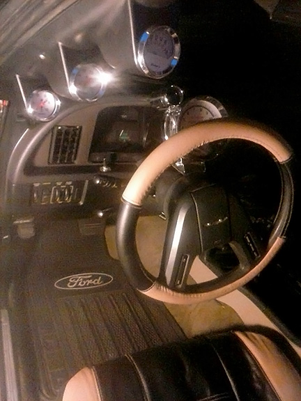

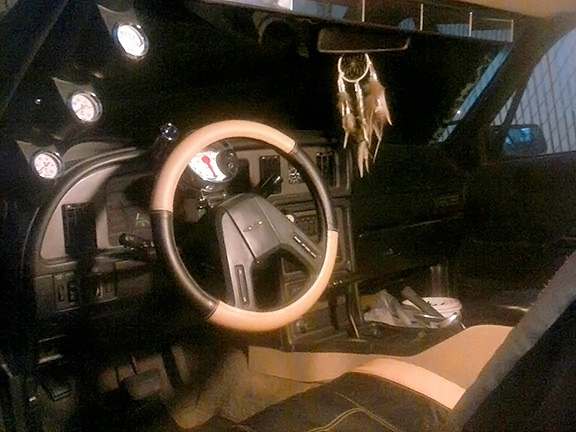

    Install 3 gauge pillar
    Install 9 New Gauges & Sensors
    *Sun Tachometer w/rev light Gauge
    *Voltmeter Gauge
    *Engine Temperature Gauge
    *Oil pressure Gauge

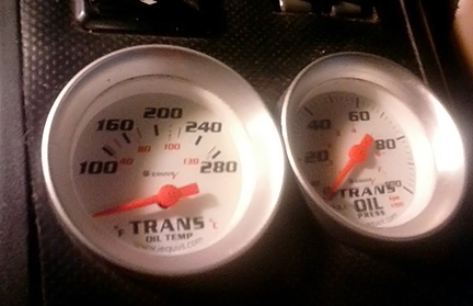

    *Trany Pressure Gauge
    *Trany Temp Gauge
    *Vacuum Gauge
    *Goody's Fuel Regulator Pressure Gauge
    *AEM Rich/Lean fuel mixture gauge w/ wideband Bosch exhaust sensor
    ToDo
    New Paint - Car
    Lowering Kit
    Tint Windows
    AC Recharge
    Hood shocks
    Brakes
    ORDERED Shipped/or in Transit

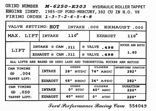

    Calculations & Cam card for the Ford Performance Racing Cam - preparing for degree & install in Tbird.

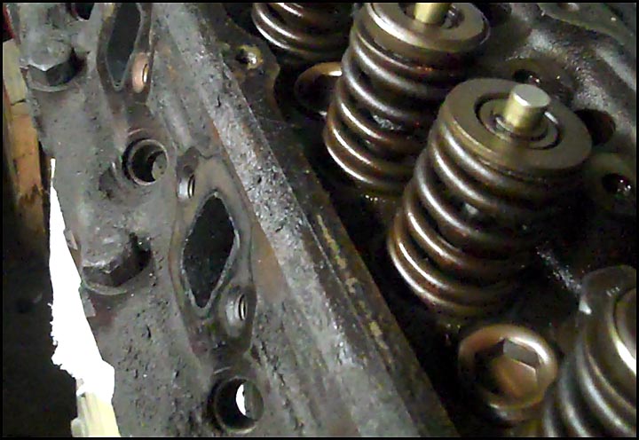

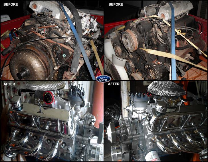

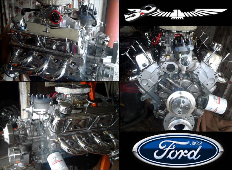

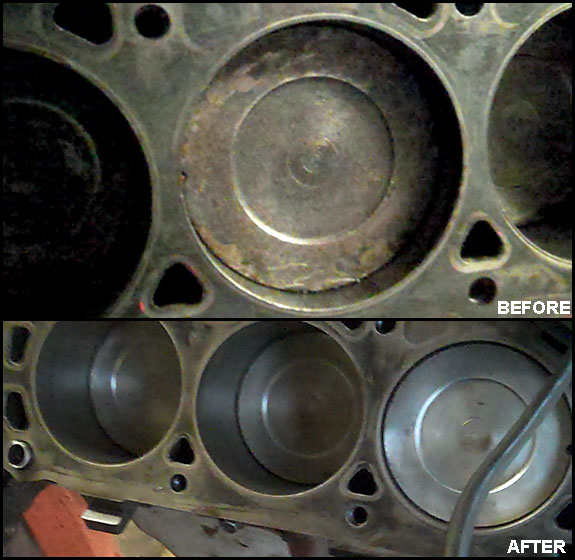

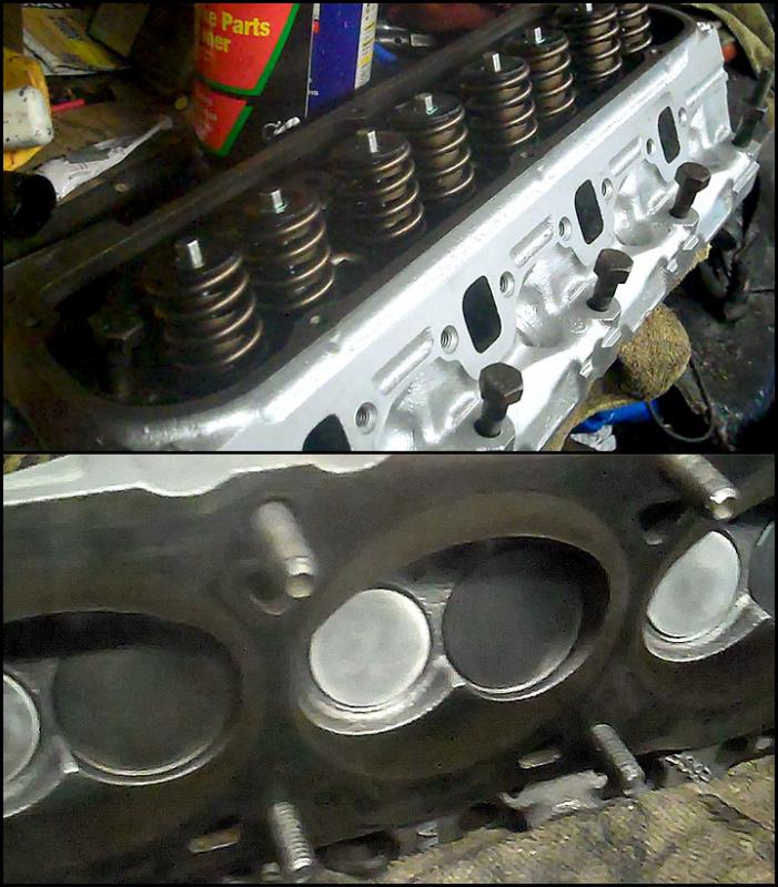

    Little update on my Ford Thunderbird build. Block is done, pistons and all are cleaned, timing gear set, race cam, seals are in, Heads are done porting with new springs set, valves are all re-lapped and heads are painted. They should be installed soon with new racing push-rods. The timing cover and water pump are on.
    Updated post:
    Completed heads & pistons - Before/After
    Now starting to look like an engine again, its nice not to have that caked on grease packing that was on the motor before the build. Hard work when you have to take a wire brush drill to every friggin thing that there is. Thank god for brake cleaner too.

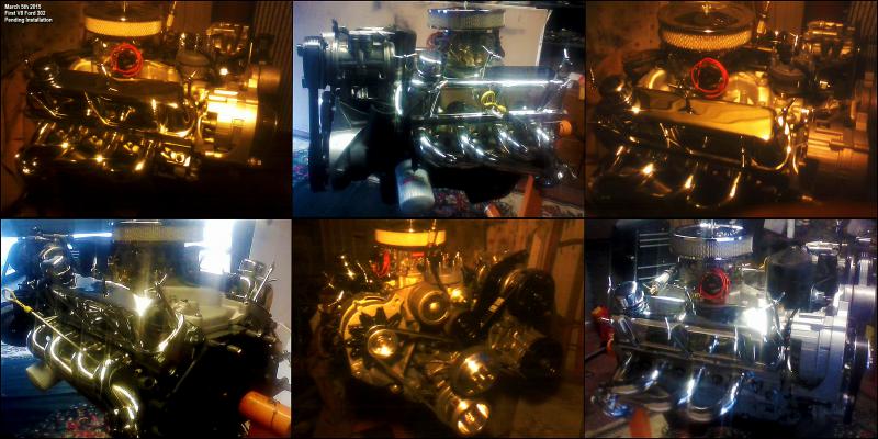

    Now the engine waits to be installed while the Thunderbird goes through it's work.

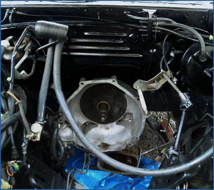

    Old motor pulled from TBird on march 7th 2015. Tugged at this for a while until I noticed the last bolt still in. pfft! Nice to see a place for the new motor to be installed. Will be removing all the left over smog hosing and cleaning up the engine bay for repainting. All black with a chromed and silver motor should look very nice I hope. I also want to remove column shift to a console shift since the car has a full console. Rare item when a column shift was installed at factory. Right now the car is sitting nose up with jack stands and will be multitasking with engine bay and putting in shift kit on AOD transmission. Things are going smoothly with this car.

    Right now I am in a holding pattern with the engine sitting in the garage all finished and the car is now on the driveway getting the rework. Have the engine bay all painted black and pulling wire and smog vacuum lines out. I hope to start the trany in a few days, the instructions say a few hours to finish, probably take me a day, lol.
    Also the trany holds a shitload of trany fluid. I think it said almost 7 quarts which is expensive, lol. I'll try to post up about the trany Kit as long as I don't mess it up.
    looks so much better then when I started. Finally having room to work around an engine when it gets reinstalled.

    Ya, but I need 2 of me, one on top guiding the motor and one under car matching the converter to the flywheel for bolting together. I have 3-4 bolts in and pulled the 2 together, so looks like I have to spend some time under the car now to line up the flywheel and bolt to the converter and install the starter all at the same time, lol. I am realizing that I am getting to old for this stuff. I use to be able to work at this stuff everyday, now I work one day and don't want to look at it for 3 days.
    Here is the latest update on my 1985 Thunderbird build.

    I have had the motor placed for sometime now and I am moving through all the other things a swap like this involves. I do this in spare time so it can have some gaps in progress. Anyway, I am back on the TBird and we are getting close to another start up. Since the last time started I have rewired all the gauges and additional items I have installed onto a separate wiring system with 2 new fuse panels. I found that the original fuse panel was just becoming ridiculously crowded and look like shit with wires coming and going. It now is clean again and sits next to the 2 new panels.
    This image is the engine installed, but it needs to be updated again since the distributor laying on top there has a new version installed now. I have been working on wiring and interior and that is pretty much finished now except for connecting the main wires, 1 for constant 12v and the other Key On 12v under the hood. Picked up a new battery and it goes in today so those 12v wires should be connected then as well.

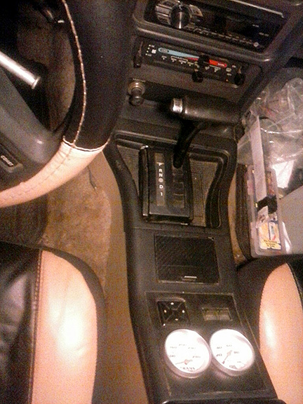

    I have changed the column shifter to a console shifter and I am presently under the car doing the requirements to have this update working just like factory. I have the cable almost installed then I have to drop the trany pan to reverse the shifter lever to change from a pull to a push for the new console shift.

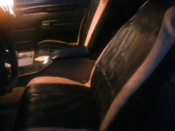

    Anyway, here are some blurry cell phone images of interior with new seat covers and dash area. This car came with a light tan interior and is being changed to black with the tan being accent color. I still have some more changes to complete this transformation. I just am getting eager to have it running now and this is the goal now.
