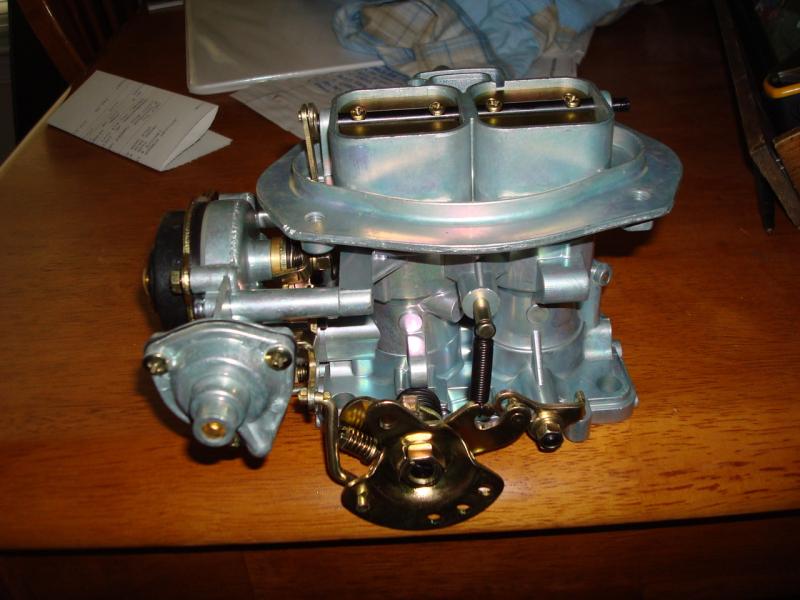

    The Weber carb conversion kit came in the mail today along with the new electric fuel pump! The conversion kit is the WK614 with the 32/36 DFEV carb and I went with an AC Delco EP42S fuel pump. Here are some pictures:
    Weber conversion kit WK614
    Weber 32/36 DFEV
    ACDelco EP42S Electric Fuel pump
    Original Mikuni Solex POS, begging to be retired!
