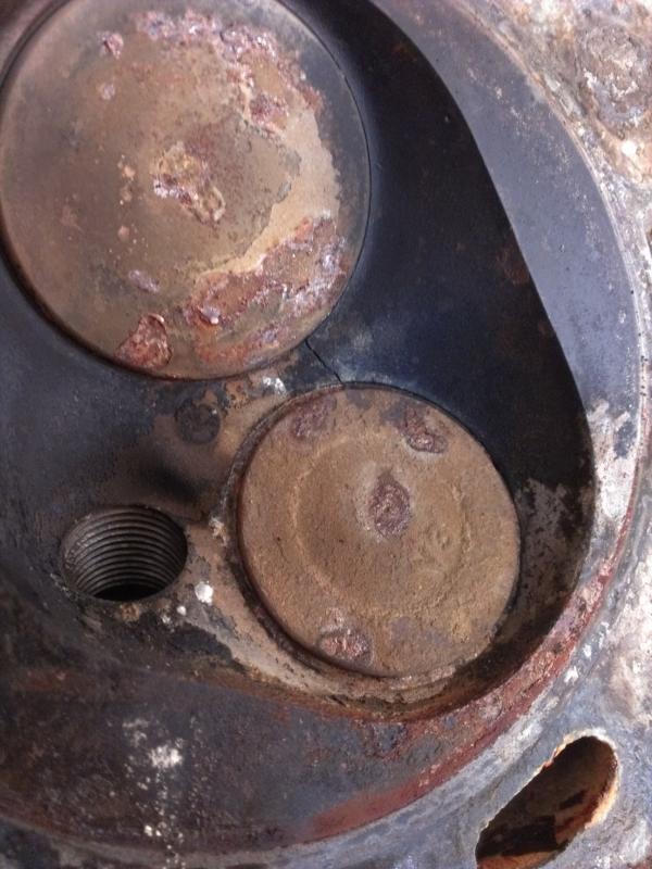

    cracked head2.jpg so little crack in my head... i dont know how long its been like this. But i think it was from the over heating... it took me over a month to take off the head, because i blew up my knee and i couldnt move, so thats why it has some surface rust... anyways, i know this sounds silly but, could i just clean them back up, lapp the valves and slap them back on and everything would be okay? Finding these heads is tough

    They have both new and remanufactured heads on rockauto for this truck that are complete if you are willing to spend the money. Not sure if you can repair the old one or not.

    A good machine shop could ATTEMPT to weld the crack. I tried to get mine repaired but the shop said they couldnt get the weld to hold properly. It takes great skill to do it. I actually drove mine for quite a while with the crack, but I dont recommend it.
