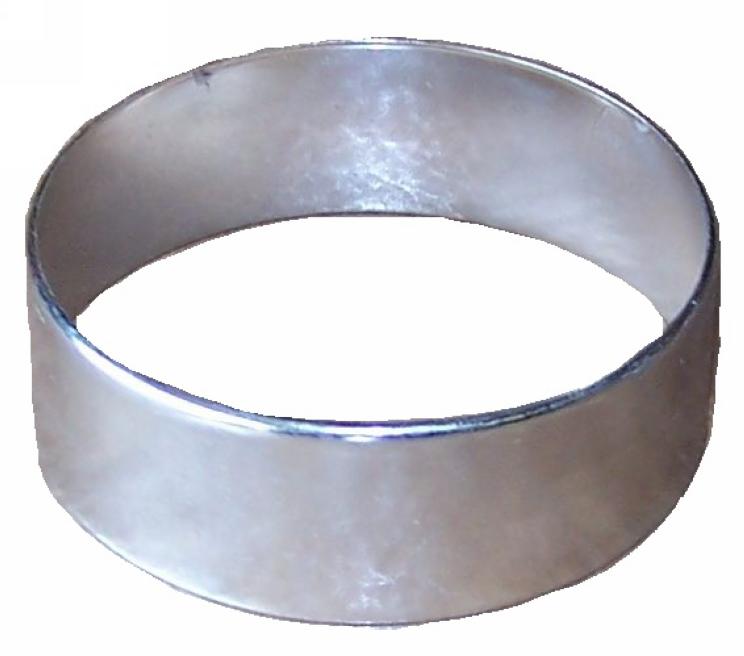

    Ok..... so here's where I'm at. Woke up at 8:30 this morning and got started. Had the timing belt off by 9am. The crank seal is fine, absolutely no oil. The problem is at the oil pump seal again. I've changed it twice, this will be the third time.. Felt the shaft for any worn grooves but found none, it's completely smooth. Looking in the area where the seal fits I do see a small machined hole there that leaks a tiny bit of oil, not sure if this is normal or if there's a seal on the back side I need to change now. The guy at the auto parts store said the problem could be... the seal I am ordering from them is part of a kit originally made up of the seal and a repair sleeve, therefore the seal has an ever so slight larger inside diameter. When used with the original shaft and no sleeve it would make sense that it would leak because the ID would be to big. I really can't confirm his theory though. Anyway, I ordered a new seal and repair sleeve just incase the shaft is worn and I can't feel it. Parts will be in Monday. I am using a thin layer of sealer on the outside of the seal. I did take the cam out today and noticed the lifters were really worn where they meet the valve stems so I bought 8 new ones. Installed them, put the cam back according to specs, and replaced the cam seal while I had it out. Love my truck and can't wait to get it running again. The guys at the fire dept. call it the wheel barrow but I would take it over any of their Fords or Chevys any day of the week. Does anyone have input concerning the inside diameter theory I mentioned. Thanks again guys
    That makes sense If it has never had the repair sleeve installed it will dump oil. Ether get the stock seal or the repair sleeve and carefully install it. Some times they come with the tool to install it. There easy to destroy when installing.

    I had never heard of a repair sleeve until my brother mentioned it yesterday. Any tips would be appreciated. Does it just slide over the shaft, do I need to lubricate it before I install, should it just press on or will it need to be carefully tapped on? Thanks.
    They are taped into place over the shaft. I would first try to find the correct seal. But if you have already ordered the repair sleeve no big deal. There just tapped into place.

    Am I correct in assuming the sleeve is tapped back as far as it will go? What do you think is the easiest, and most gentle, way to tap the seal on? Looks too thin to risk tapping it on with a socket. Would you lube the inside before sliding it on or will that compromise the function later on.? Maybe lube it with some WD40. Thanks
    Depending on how large it is just hit it with a mallet or if you have a tight fitting peace of pipe. You can even warm it in an oven to 350 and quickly. I'm talking quick. slip it on the shaft. Out of the oven and on the shaft with in 2-3 seconds.

    If you put the balancer in the freezer and heat up the sleeve it should drop right on, just don't use your fingers to pick up the sleeve when hot.

    Balancer is still in the moter, and I'm working outside so it would be a t least a minute before I could get the sleeve outside to the truck. Probably gonna lube it up and tap it on gently. The sleeve came with an installation tool. Thanks guys...
    It came with the tool. Should pop on with no problems.
