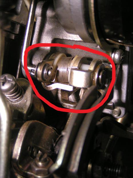

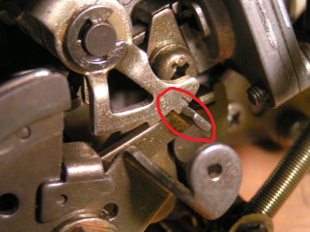

    Before you start it, open the throttle about 50% and release it. Check that the fast idle cam has rotated enough that the throttle lever contacts the cam near the end of the cam as circled in this picture:
    If it's not at the third notch or beyond as in the pic, thoroughly clean the cam linkage and lube it with a light oil.
    The spring for the cam is quite fine, so dirt and grime can cause it to unwind slowly. When operating properly the cam, its linkage and the choke valve should move freely and snap into position when the throttle is opened quickly.
    If the lever-cam contact is correct and the linkage fine, check the delay valve and its vacuum hose on the valve cover side of the carb. With a hand pump, the vacuum should leak down slowly - about 1" Hg per second.
    Thanks, will try this in the morning. Dumb question, but what is the best way to get good access to this area to do all of this? I had a hard time getting my hands in there while doing the fast idle test, and didn't have a direct view of what these pictures show, even with the air filter housing removed. Do I need to remove the carb? (hope not...)

    Don't remove the carb. It's a real hassle and shouldn't be necessary for this problem. Best access is afforded by removing the air cleaner, but you're correct, things are still cozy. Removing the throttle lever end of the dash-pot-to-throttle-arm spring will make it easier to see the cam/lever contact points. (I removed the spring to get the above pics.) Other than that, a small mirror and flashlight are the only other things to recommend that will help your evaluation.
