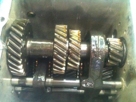

    is that gear oil or metal on the teeth - its hard to tell. Was there metal shavings on the pan or in the oil?

    thats oil and no there wasnt shavings
    It could be the pilot bearing in the end of the crank is toast. It will cause all kinds of problems if it's bad. Then you can destroy the input shaft bearings. Sorry to say it, but I would pull the trans and replace the clutch and inspect the shaft and make sure the trany bearings are not bad. The input shaft should move around some but not a lot.
    I second that - once you get the tranny out grab the input shaft and see how much play there is - I'm betting alot, aka dough mixer.
