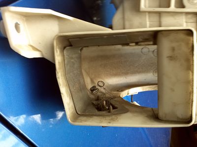

    Okay, I finally got around to replacing the blower motor. I popped out the glove box for access, and removed the one nut and two bolts to drop the assembly and then the three nuts to remove the blower motor. If I can post the picture, you will see that my heater resistor has been damaged. After I replace it and the motor, do you think it was the resistor that as the problem and that the motor was okay?
    If the resistor was shorted to the motor, then yes; but the resistor may have failed due to the motor drawing excessive current and overheating the resistor.
    Thats not good - it should never get that hot to melt things no matter how old it is.
