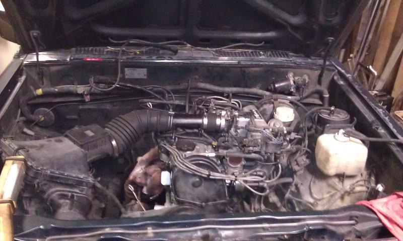

    So I got my 86 home today and it's time to do my build thread on my diesel. Warning! this thread is going to be pic heavy and don't expect it to be overnight I've gota take my time, do it right and wait for paychecks to do what needs to be done.
    So I found a 84 5-speed 4wd Power Ram50 royal that was pretty much a hunting truck with a turbo diesel 2.3L with a blown head gasket and the body is toast. Cost: $500
    The donor:
    Then after I got the diesel home another first gen showed up on craigslist. It was at a local shop just around the corner. They had tried to repair the engine by putting a larger bearing but no good. It's a 1986 2.6L 5-speed 2wd. It has a blown engine and the body is perfect exept a few rust spots (but how many first gens dont have rust?) This was bought from the original owner's grandson. He bought it and left it at their beach house in Emerald Isle so it's got 27k original miles and so does the engine. Btw the engine will be for sale with manifolds, accessories, carb, new carb kit, etc once I'm done. It'll need a new crankshaft. Good for someone who's got some 2.6Ls laying around. Good for parts. It ran great and smooth just had a serious knock. Cost: $875
    The recipient:
    My plans for this build are to remove the diesel cab and bed and swap the clean 86 cab and bed onto the frame of the diesel truck. I'll remove the diesel drivetrain and rebuild it while it's apart, strip the frame and clean/POR it then go through everything, swap over the power steering and hydraulic clutch to the clean cab, paint the engine bay and re-install everything. The only reason for this is to keep 4wd. Swapping it to 2wd would be easier but I want to have 4wd which would mean modifying the entire frame of the 2wd truck. Plus this prevents me from having to swap the fuel system on the gas truck to diesel. The diesel's frame is solid just needs cleaning and painting.
    Before I get elbows deep into this project I've gota get my 94 Mighty Max running again for a go getter to transport parts. Should have that going next weekend. I'll be finishing rebuilding the 2.4L EFI engine this week. This truck will be for sale once my project is done also.

    I have a green decent 94 MM with a rebuild 2.4 on the stand waiting to go in this weekend.
    I have a white rusted out (body only) 84 D50 with a diesel 5-speed 4wd that needs a head gasket, it's gona get a whole overhaul.
    I have a red super clean original with 27k miles 86 D50 with a 2.6L with a spun bearing. It runs smooth and pulls hard just has a terrible knock like it's going to blow any second.
    The red one is getting kept (the clean one) The body is going onto the frame of the white diesel so I'll have a 2.3L TD 5-speed 4wd truck with 27k miles. I'm going to strip the frame down and re-do it all so the engine, entire driveline and all the fuel systems and such will have 0 miles, the body will have 27k. The red one has clean grey interior exept the dash has a few splits and the top of the seat is torn. The interior on the white one is tan and has a toasted dash and a super clean tan seat. It's also got a tach cluster :D
    After that I'll have a spare 2.6L engine, a spare body with glasses and 2wd frame to part out along with a set of new 14" capitols on super clean (almost brand new looking) Sport 5-spoke wheels. These won't be used since I've got 15s on my 4x4 frame.
    The red truck's body is spotless. It has 2 holes in the bed smaller than a dime from rust and the lower section of the passenger fender has about a 1.5" section rusted out. I plan to repair it when I yank the fenders to pull the cab. Along with the 2 holes which are in the bed. I found out the bed sides can be unbolted from the floor and the insides can unscrew allowing repair to the inner part of the bed sides. Get that rust stopped for good.

    Finally got the engine in my second gen. Should be firing it up tomorrow. Once its going i can start my project
