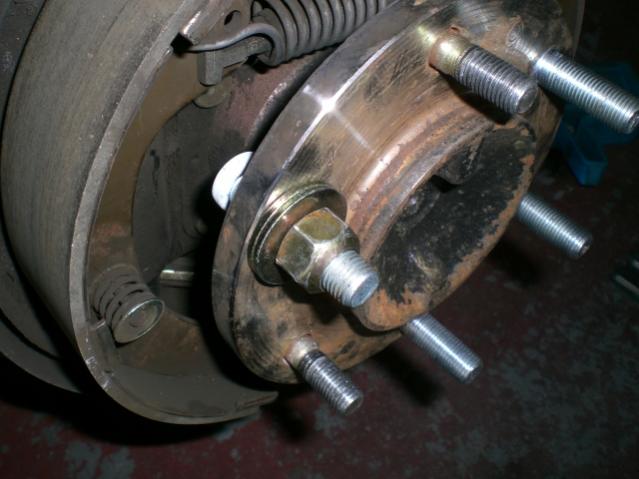

    Today I installed the rear wheels/tires. I wanted to retain the rear center caps, Dorman doesn't make a adapter nut yet (double nut) that would have made it easier. What I did was install the larger studs (14/1.5) to retain the stock Silverado lug nuts. I made a press tool out of an old C clamp to push out the old studs and drew them in with 2 washer/nut/impact tool method. No axles were pulled. Enjoy....
    *The studs fit 1997-99 Cadillac Deville (rear 6 lug) Dorman #610-432, or Napa NOE 6414123
    * drill bit to drill for studs 39/64"
    * drill bit to drill drum 9/16"
    * 2 grade 8 1/2" washers and Napa # NOE 641-3244 wheel nut

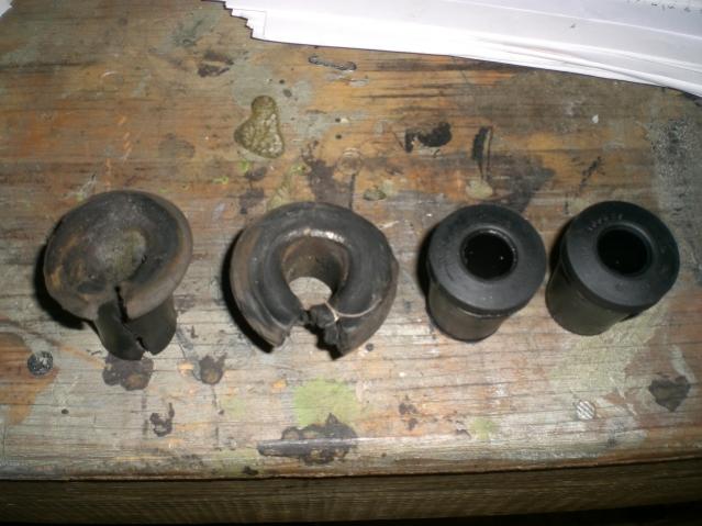

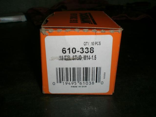

    Well I got the suspension done yesterday.....man this 52 year old is tired, well that and I hit my hand with a hammer...damn ball joint fork . Anyway, it looks and handles great. I replaced almost everything, bushings, ball joints, tie rods, re greased bearings, shocks, redrilled hubs for 14x1.5 studs etc. etc. etc. oh and lowered rear too. Here's some pictures of the carnage. The front studs fit 1980's Toyotas, part # on box, drill bit 5/8". Enjoy.
