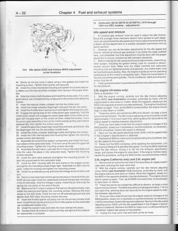

    That's a good idea before starting to turn screws. There's one that's not supposed to be adjusted and the Haynes manual is pretty clear on why. I can try to scan my manual and post it for you but no guarantees. My connection is a dial up and pics and the like take forever.

    I went to the Mitsubishi manual and it said for engine dieseling:
    1.) carb; idle speed too high needs to be adjusted
    2.) FBC system; Slow cut solenoid valve malfunction
    I adjusted SAS 1, the carb idle speed screw. When I adjusted the screw in I was able to get the idle to increase in RPM. However when I adjusted the screw out the idle would never go lower than the previous idle speed no matter how much adjustment I made.

    have you checked you throttle cable adjustment? Perhaps it's too tight and won't let the throttle close.

    perhaps this will help.
