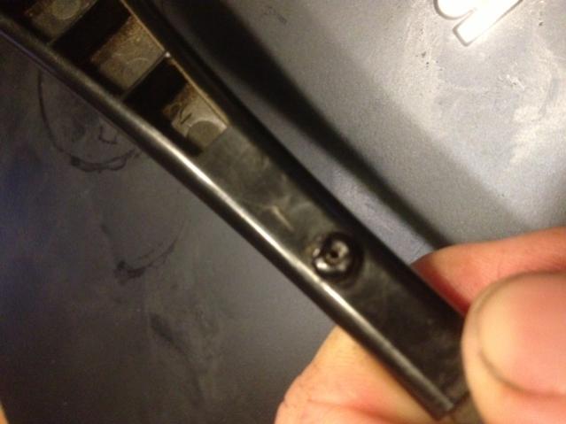

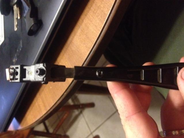

I got one in the junk yard for 2 dollars I can figure out how to get the old one off. might just drill it out, but I dont wnat to screw up the new one. Ill post a pic tomorrow
^ thats wassup. mine's busted too and I cant find any in the local JYs. well it still works but feels like its gonna break every time i twist it. but yeah if u can get a pic up that'd be great. heck if u figure it out start a DIY thread on it, since I'm sure it'll come in handy in the future. thanks.
wiper arm 2.jpgwiper arm.jpg this is the arm but I cant figure out how to get that little bolt or nut or screw out. any clues
idk but from the pic looks like thats all one assembly. doesnt look like that bolt/nut u referred to can come off.
Bon't pull the bolt.. it's a wiper blade. The end is plastic. The arm has a U on the end. There is a little plastic release clip. You push it then slide the plastic end back toward the base of the arm. It is in the package with the new blade.

I dont think he even looked at the pictures lol
lol i think ur right.. he probably just glanced at it real quick and though it was the actual arm.its the beast at area 51 keepin the mad scientist hella busy
