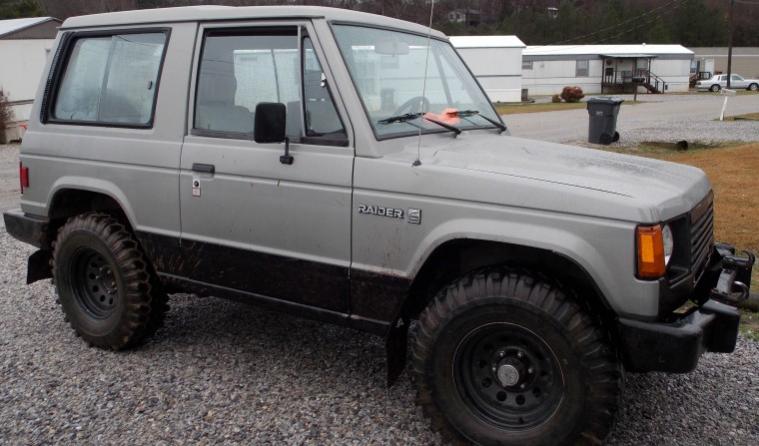

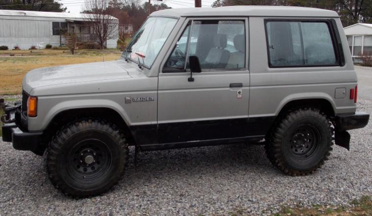

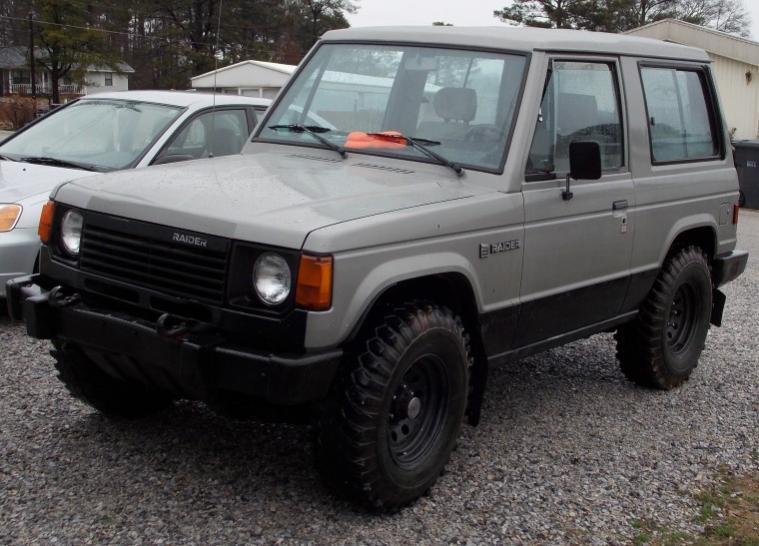

They dont look as big as what they are in the pix. Says 33x10.50x15 on tire but just dont look that big lol. but here it is for all that ask for it!

Now it's time to put it in the mud and try them out![]()
And the truck looks bad ass![]()

i dont have any lift on there at all. i will get one one day. i cant find a suspension lift anywhere
It looks good
thanx maxin need to find a lift for it! any help on that?

damn blake that looks badass bro. IMO u dnt even need a lift kit, looks great like that too. and perfect color combo w/ the body. very beefy, hows the turning in the front? any rub?
thanx bro! a lil rub might take off the ends of the front bumper not sure yet. i want a lil lift to fit 35s and ill be happy happy happy lol
well at least it dont rub too much on the suspension or sumthin. i feel ya on the 35s, its either "go bigger or go home" i guess. haha![]()

A Raider on 33's isn't uncommon. To run 35's you'll be looking at a body lift and some additional trimming just to fit. Then, you'll really want more power and bigger brakes. Body lift alternative include using Toyota solid axle front shackles in the rear of the Raider/Montero/MM and Gen II Montero upper control arms.
