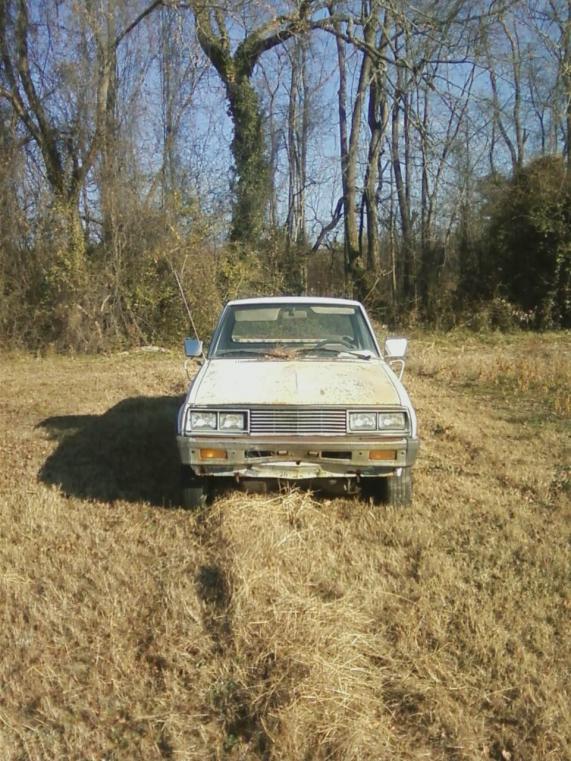

    That's good to know. That was my biggest obsticle. Knowing it's easy to convert it to a 2wd then I'm pretty committed on getting this truck and doing the swap now. I have to see it first. He says it has no compression at all after overheating. I've read it could happen on the diesel. Worst case get a 4d56 head. The doner isnt much to look at (that's why he wants $500) but I hope to pick it up next weekend and have pics in the next couple weeks of the progress. Maybe even have some first gen parts for sale since all I need is the drivetrain and harness.

    I do have pics he sent me.
    No luck on the bumepr tho. End caps are good tho lol
