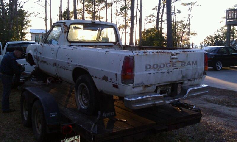

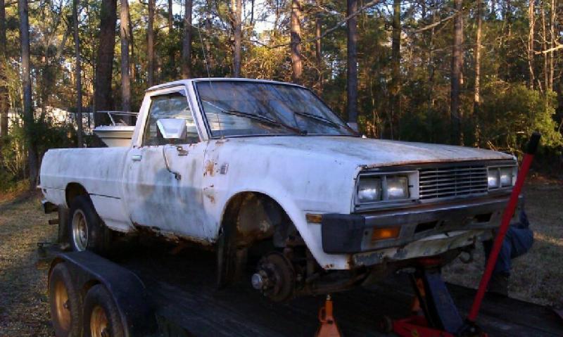

    I payed 500 for it. The body is gone. Rockers and floors are rusted out but the 2.3 turbo diesel is stout. After getting it i like the 4 headlight first gen more. I may abandon plans to drop it in my 2nd gen and sell the 2nd gen with rebuilt 2.4L. A local guy has an 86 with 27k original miles. Owned by an elderly man. It has a spun rod in its 2.6. I may drop all the diesel parts into that truck. The body is flawless just faded since its dodge red. He wants 875 for it with clean title and it runs.

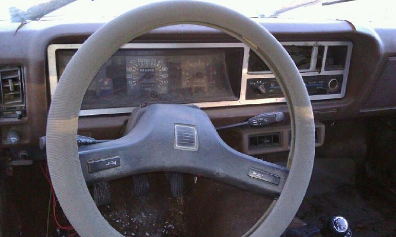

    Im going to pick it up friday. I'll have pics this weekend. The guy said if I didnt get it he was going to buy it off the elderly man (original owner) and dismantle it for parts so I had to save it. The new tires are worth about half what he's asking for it. The swap into that truck will be pretty simple. Just have to modify the firewall to accept hydraulic clutch instead of cable since the diesels had hydraulic. Also the diesel has the tach cluster and p/s so I'll swap those into the 86. It has a leaking steering gear box tho. Gota find a rebuild kit. Down the road I'll have to look into adding a/c since it's got the pulley for it. Then I'll have a super luxury truck that can haul anything (within reason for it's size)
