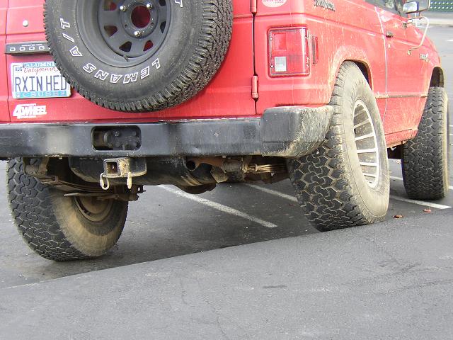

    i just came across this thread and was thinking, didnt u already put them on? lol but looks like they fit right on..looks great even w/out the lift kit IMO

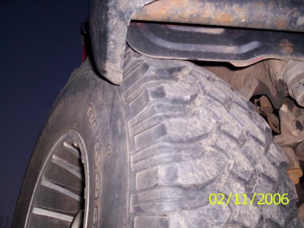

    This combination works out without issues. Trim a bit off the front bumper ends and push the leading metal edge of the inner fender well forward.
    I put almost 100k miles on my Raider with 33s mounted most of the time.
