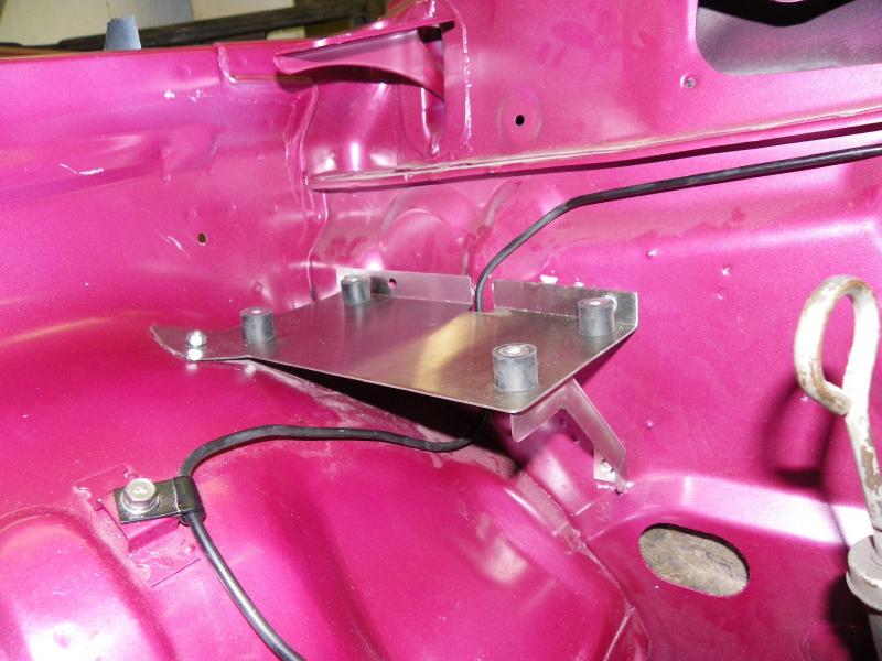

    Easy enough just find a tray from a full size Ford or Chevy pick up as they are removable and mount it in this area.
    as for feed wires just go to home depot and get some 4 gauge wire and the compression ends, then go to an car audio store and get a power distribution block and tie the 4 gauge into the original battery cable.
