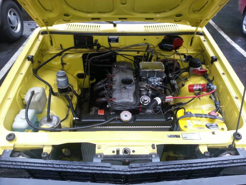

    So far the task seems pretty simple and straight forward, but it's that level of thinking that has gotten me in trouble before.
    Here is what I'm currently working with:
    The battery currently sits in the driver's front, but I would like to move it to the passenger's rear (don't get too excited). I guess what I'm looking for is feedback on thoughts of how to set up the battery tray as well as what gauge wire and how to run the wire.
    F.Y.I. - There are a couple of brackets missing that hold up the braking fluid lines. I just took those off to paint them. Along with some other parts such as the windshield wiper fluid "squirter". lol But otherwise that's what I'm working with.

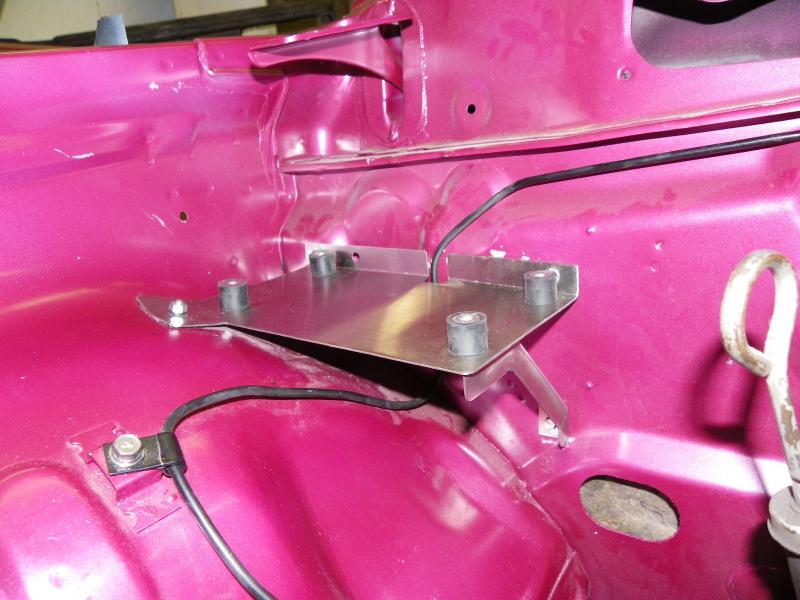

    Easy enough just find a tray from a full size Ford or Chevy pick up as they are removable and mount it in this area.
    as for feed wires just go to home depot and get some 4 gauge wire and the compression ends, then go to an car audio store and get a power distribution block and tie the 4 gauge into the original battery cable.

    Good info guys. Sounds like my original thought about it being a pretty easy, straight forward task was on the money. I'm just excited because with the battery out of the way, I can start putting together the cold air intake that is going to go where the battery is now.
