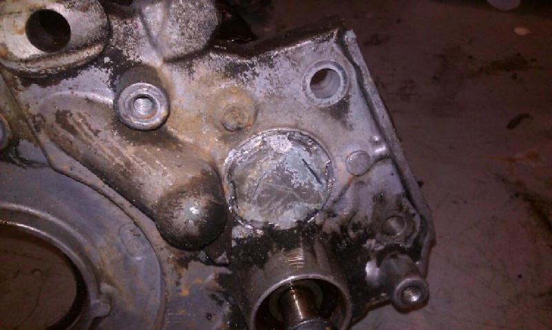

    So I've got my engine torn down to a bare block now. I'm looking at my oil pump and in my box of goodies I have a crank seal and balance shaft seal to put back in it but does anyone know where I can get the tiny rotating seal for the oil pump drive gear? Also how do you get the oil pump drive shaft out? that cover above the pulley is stuck and I cant seem to get it off to get the shaft nut out

    Yea but how do you get that plate off to get the bolt off the shaft? Ive tried turning, prying everything.

    Thats what im trying to do lol the cover plate is stuck in the pump

    Well, there is a seal all around the plate, refer to page 2B-15 of the Haynes manual for details.

    Ive got the pump and shaft out. Its like that balance shaft plate is seized in the pump

    No. Im at the prior stage. Remove the plate with the 6 ears that covers the bolt. Its stuck

    Mitsubishi lists a special tool to unscrew this cap but mine is seized and won't turn out. I think the old rubber seal has it stuck.

    Just take a little chisel or a flat head & hit it with a hammer the direction to loosen it

    Thats what ive been doing but all it does is chizel the ears off the plate. She's stuck stuck.
