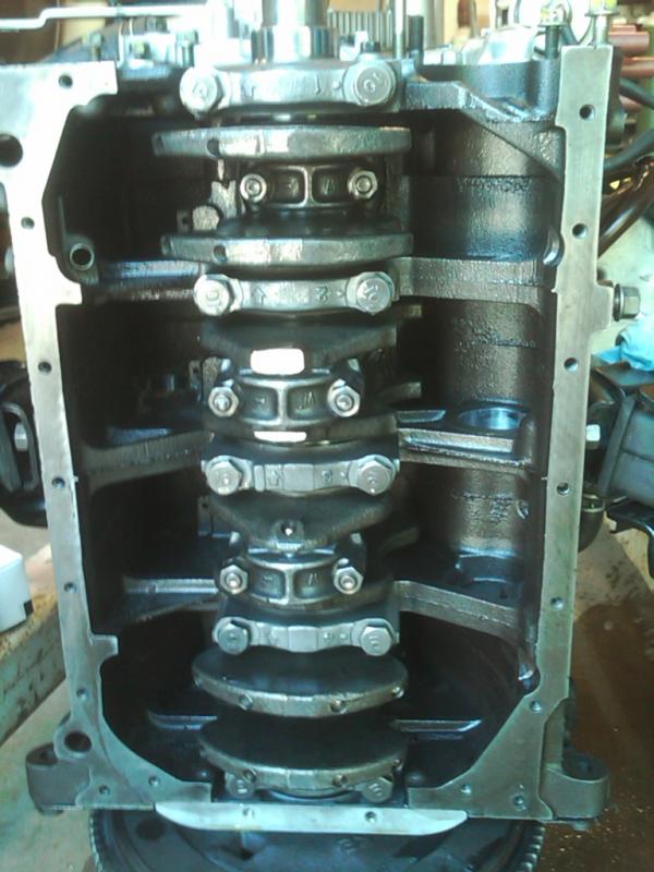

    Camoit suggested we do it on mine, since machine shop messed up and caused my oil pump sprocket to drag da engine to a point where it seized. So we went to machine shop and made da owner order me a delete kit, then we installed it in less than an hour. motor was out of my truck tho. Haven't had a chance to drive it yet, just put da motor back in yesterday, but it seemed to rev. up easier and it's smooth i'll see how it feels when i get it on da road.
    internal pic after removing balance shafts below..
