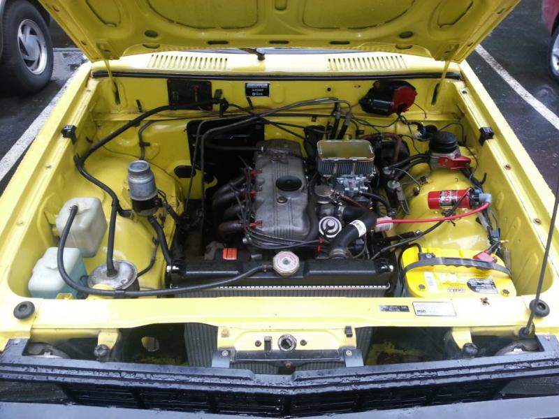

    So far the task seems pretty simple and straight forward, but it's that level of thinking that has gotten me in trouble before.
    Here is what I'm currently working with:
    The battery currently sits in the driver's front, but I would like to move it to the passenger's rear (don't get too excited). I guess what I'm looking for is feedback on thoughts of how to set up the battery tray as well as what gauge wire and how to run the wire.
    F.Y.I. - There are a couple of brackets missing that hold up the braking fluid lines. I just took those off to paint them. Along with some other parts such as the windshield wiper fluid "squirter". lol But otherwise that's what I'm working with.

    I don't have any suggestions for the battery tray or where to run the wire, but I do have a battery relocation wire from a mid '80s e30 BMW. I don't know what gauge it is, but it's what they used to run from the engine compartment to the trunk, so it should be plenty stout and long enough.
    Try your local welding shop. Get some welding ground wire. Comes in all sizes and is super flexible. It will handle and amp you need. The local battery shop can stick the ends on you need.
    Easy enough just find a tray from a full size Ford or Chevy pick up as they are removable and mount it in this area.
    as for feed wires just go to home depot and get some 4 gauge wire and the compression ends, then go to an car audio store and get a power distribution block and tie the 4 gauge into the original battery cable.
    The ram 50 diesels mounted the battery behind the front lower panel on the right side of the bed. For wire you could use welders cables, or get a battery relocation kit from Summit.

    Good info guys. Sounds like my original thought about it being a pretty easy, straight forward task was on the money. I'm just excited because with the battery out of the way, I can start putting together the cold air intake that is going to go where the battery is now.
    Most any Auto Battery store can help you on the leads (there's one on Union in Seattle!). Scrounging a diesel plate wouldn't hurt, but fabricating one shouldn't be that tough if you have a bending brake, or access to one. Send me what you need for dimensions, mounting legs, and desired material, I'll bend you one...and send it up there. If you can do a plan via Sketchup or similar file, would be easier for me (mock it up to the fender with cardboard, the do it in Sketchup). I can weld mild steel, but not stainless (or aluminum). Hell, I can make it in Perspex (plexiglass, or even Polycarbonate) if you want to pay materials!!
    The heavier the gauge on battery/starter leads, the better, IMHO.
    Any Auto Stereo store should be able to make the new leads, as well. They will be prettier, and carry a heavier price tag.

    But for a battery box replacement look here. there nice and you can weld them on. I think it will fit under the hood, not sure so it's best to measure first. http://www.ruffstuffspecialties.com/...teryBoxes.html

    If you got a drill you can cut and drill a flatt bar and use it to clamp the battery down with 2 if the long J hooks.

    I've done alot of relocates on cars not trucks. You can run a good 0 or 2 ga amp wire and it'll work fine too. But audio wire may be more expensive than an advance auto parts set of cheapo jumper cables. It's the positive you have to move. Ground can be transferred with battery and bolted to the body and block on the opposite side.
