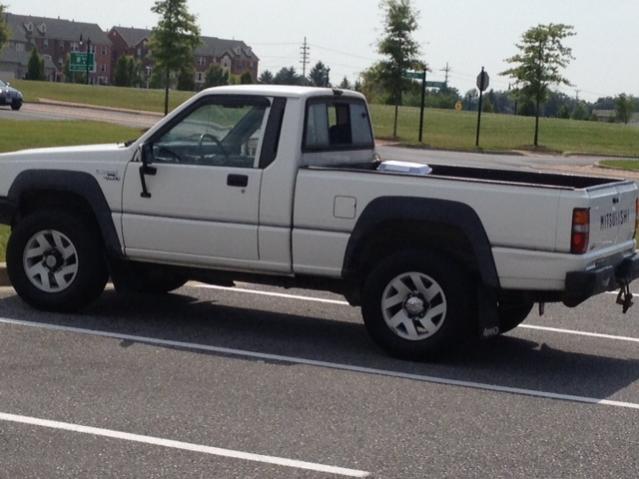

    Thanks again. I am trying to post a pic of my truck too.

    I have a 5 speed manual and I believe the motor is a SOHC, '93 or 94. I got my truck with a blown engine for $200., (run without oil), and I found this motor on CL. The guy that had it bought it to put in his Montero but it got totaled while parked in front of his house a day or two before he was going to install it. He kept it for a couple of years looking for a truck needing an engine but couldn't find any so he put it on CL for BO. I got it for a $100! It had a little surface rust but still had the import tags on it. All it needed was to have the injectors cleaned and it runs great. Your truck body looks in great shape so I wouldn't hesitate replacing the engine. Good luck!
