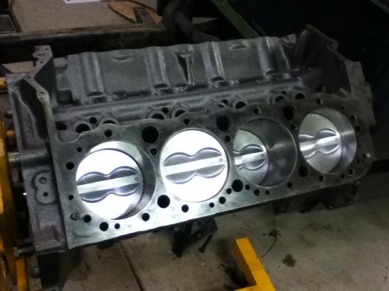

    Current work:

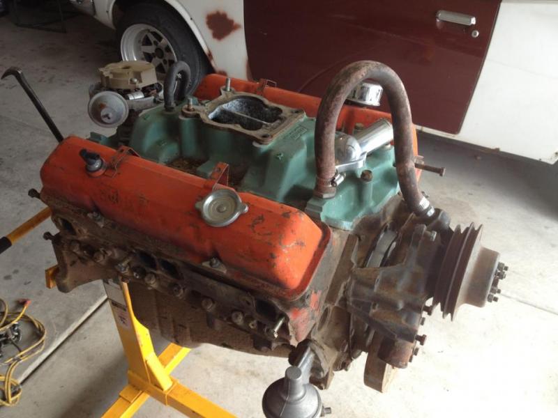

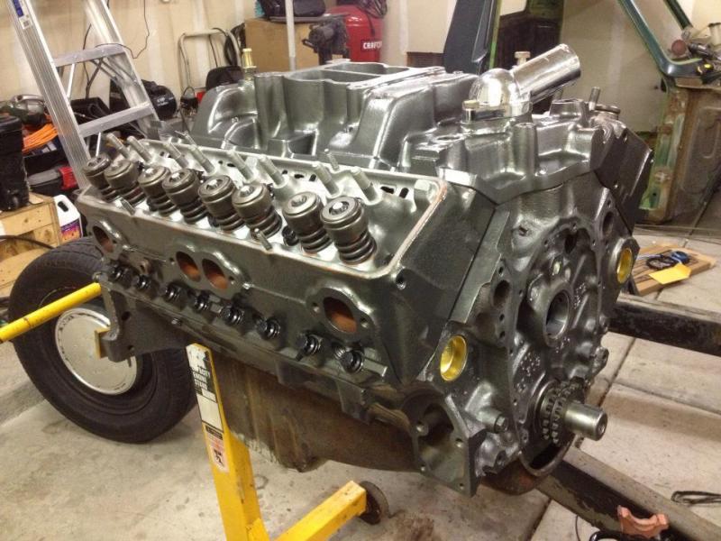

    '75 Chevy 350 -4 bolt
    WCT5 transmission
    Bottom End-
    Block- Bored .060
    -New pistons
    -Reconditioned rods
    Crank- 10-10 grind
    -ARP Main bolts
    Top end-
    Heads- Rebuilt stock.
    -All new parts (valves, seats, seals, guides, springs)
    -Magnafluxed and resurfaced
    Intake- Weiand power plus
    Camshaft- Comp Cams Extreme Energy XE262H (advertised I-262, E-270)
    -Comp roller tip rockers, lifters, push rods
    Exhaust/Fuel delivery/Suspension all to be determined...
    It's still got a ways to go, but I'm hoping to be driving it next summer.

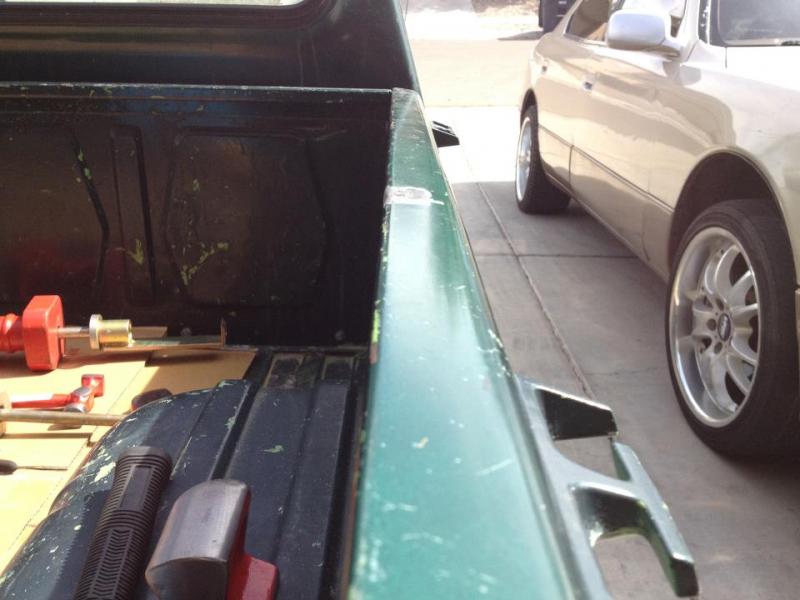

    Had to rebuild the carb and do some spring cleaning
    Started to do a little body work while it was still running.
    536801_433879693306935_1566446580_n.jpg 562204_433879879973583_165979311_n.jpg
    205240_458306950864209_82065080_n.jpg 295274_487014181326819_1242419519_n.jpg
    welded all the trim holes
    uncovered the old mirror holes and welded them

    Heads are on and intake is temp installed. Going to pull it off the stand and connect the trans to start mocking it up on the frame.

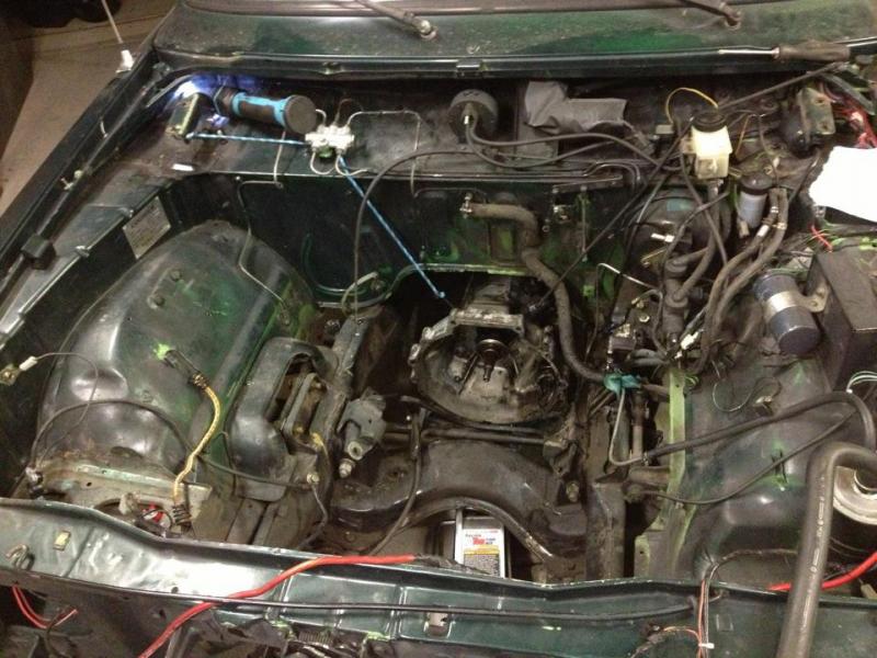

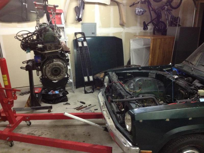

    ~And this is where I'm at as of today~
    Had the day off today, so I got back to work on the truck.
    Lined up the engine/trans to see how close it was. The pictures are after I lifted it back up a little. The oil pan set on the cross member and there was no way it would even come close to fitting.
    150902_542524012442502_110200066_n.jpg 382035_542524059109164_220065312_n.jpg
    Cut the center of the cross member out.
    524866_542589779102592_840599018_n.jpg 481439_542589812435922_1770970196_n.jpg
    Set the engine back in. Now I have to cut the frame around the bell housing. It's too wide to drop down in there. The starter hump and the slave bracket rest against the sides and won't let it go down.
    I'll also have to get different engine mounts. These are sitting on the frame right now, and I still want the engine to set about 4 inches lower than it is.
    It's going to be fun come time to do the exhaust. The frame rails are directly under where the exhaust would turn down.
