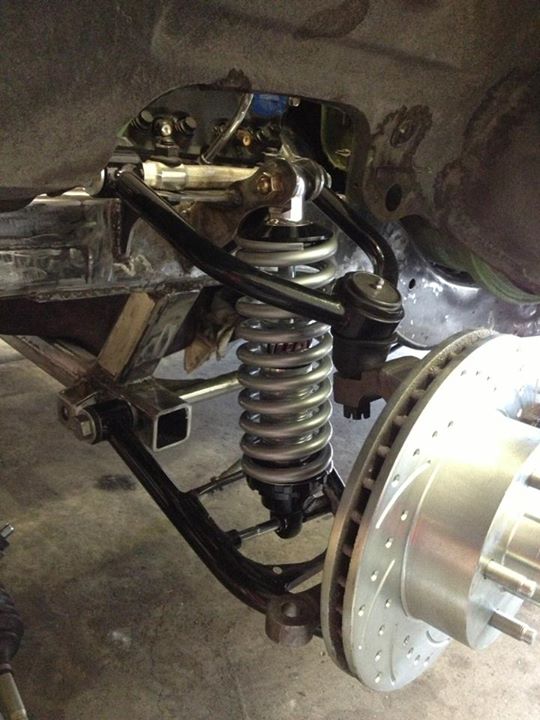

    Haven't had time to do anything recently. I did get half the rear end done a few weeks ago and got the front brakes put on.

    Suspension ordered sunday, should be here the end of this week or beginning of next week.
    Went to the scrap steel place here and picked up some 4" dia x 1/4" wall tubing to make the exhaust holes in the body mounts. Got the driver side done yesterday.
    The axles came in today and are a perfect fit.
    Once the suspension is on, it's going to Solid Tech so Sean can build the headers and exhaust. I decided not to do them myself.
