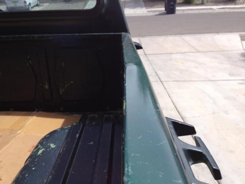

    Had to rebuild the carb and do some spring cleaning
    Started to do a little body work while it was still running.
    536801_433879693306935_1566446580_n.jpg 562204_433879879973583_165979311_n.jpg
    205240_458306950864209_82065080_n.jpg 295274_487014181326819_1242419519_n.jpg
    welded all the trim holes
    uncovered the old mirror holes and welded them
