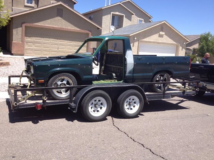

    Sent it off to the shop for the exhaust today. He won't be able to start on it until the end of the week or beginning of next week, but it frees up some space for the rest of the work to be done here.

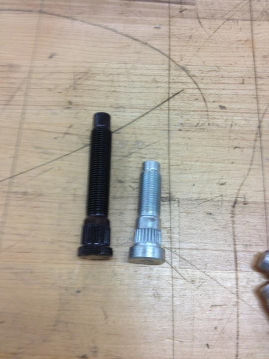

    I had a problem with the wheels not fitting due to the tapered center bore. I used some spacers to keep them sitting flush and had the lug nuts holding on by only a few threads. Since it's only for rolling around, I figured it'd be alright, but when it came of the trailer one of the lugs couldn't hold on anymore and ripped out the few threads it was holding on by. Obviously, this caused a problem since I only had two lug nuts on. So... I went with my original plan, which works for both the spare wheels, and the wheels I'll be using later.
    The knurl was .030 larger so I took them to some people who like to work for beer.
    Then I just had to cut the end of all the closed end lug nuts. lol
    Worry not... this was only to get it back on the ground so the exhaust can get done.

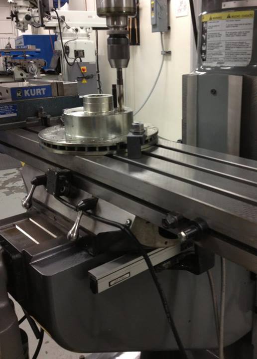

    Damn, look at that friggin drill press. There is a word for something like that...it's called SPOILED.
    If it belonged to a person, I would agree. Lol
    but it happens to be owned by the government... That's all I'm saying.
  9. #84
    3,846
    I believe the word you are looking for is Bridgeport.

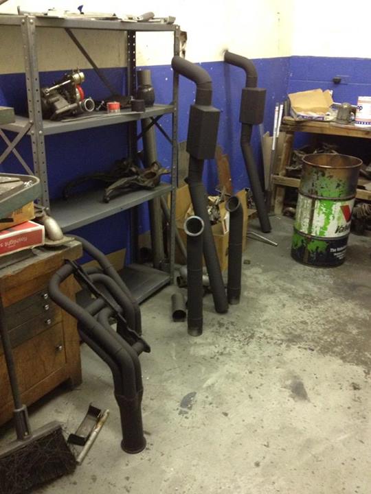

    A little more progress. They're looking to have it done by the 15th. The spintechs came in friday, piping came in today.
    It will be header to midpipe connected with a v-band, then slip fit to the rest of the exhaust. It was originally going to be header then one pipe going back, but the tight fit of the v-band through the exhaust hole in the frame would cause me to have to pull the rear wheels just to pull the exhaust off. This way, I can also be obnoxious and pull the exhaust off and basically long tubes to make a bunch of racket. lol

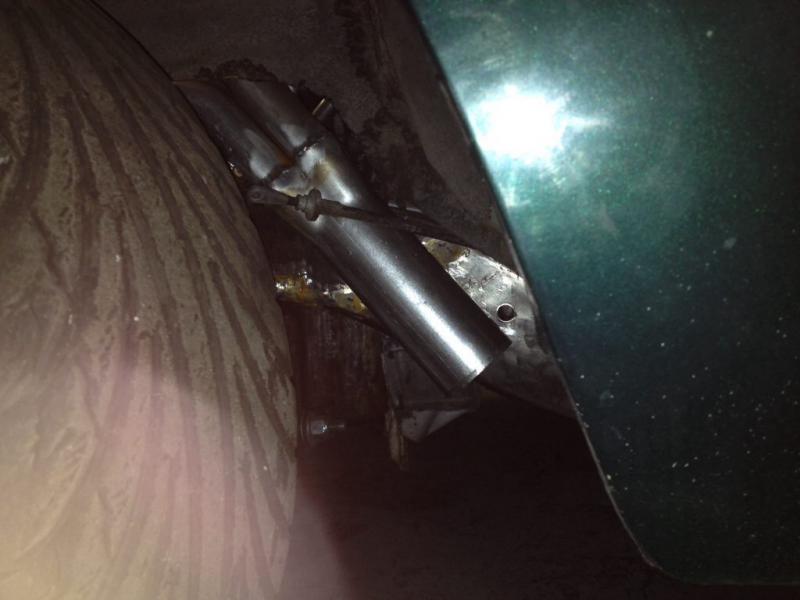

    The headers and exhaust are finally done. Now I can get back to finishing the frame and suspension.

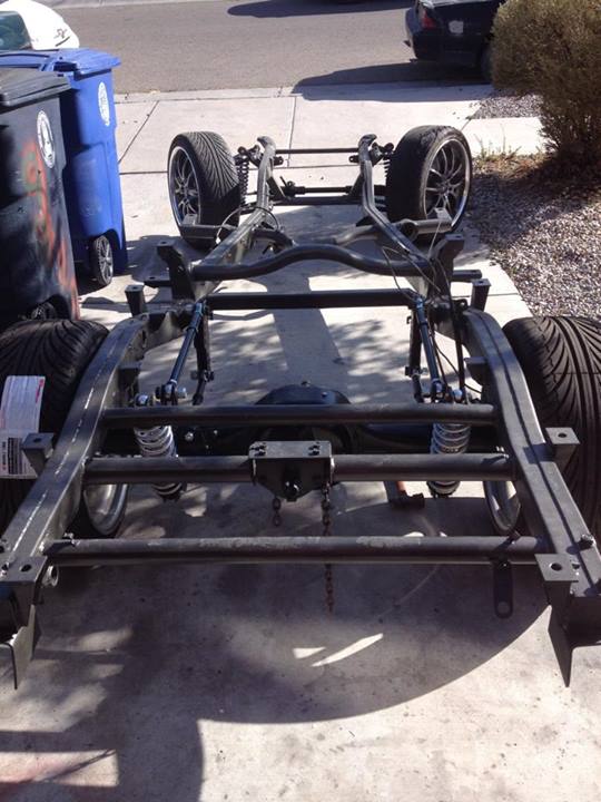

    It's been quite a while since I updated or did much work.
    After it came back from getting the exhaust built, I stripped it back down to finish some welds and paint the frame and suspension parts.
    Put the frame back together this week.
