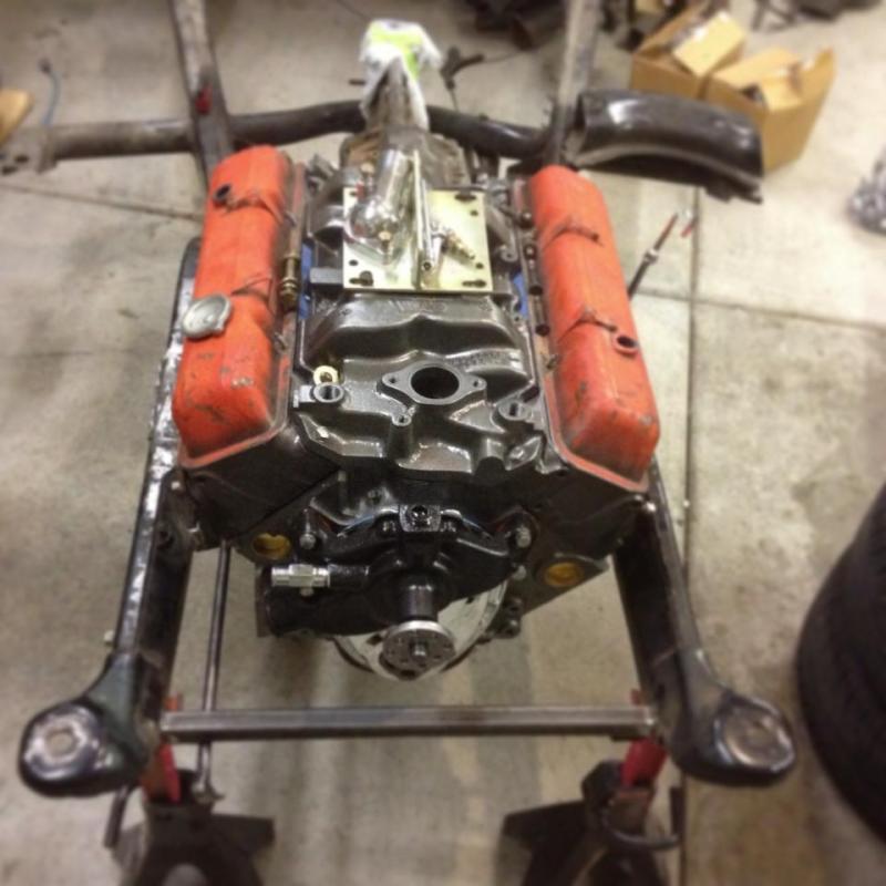

    First thing I had to do today was cut the right engine mount tabs off and lower them. The right side was about 5/8" higher than the left side. It's level now.
    Set the cab back on today to see if everything clears, marked the floor where I need to cut for the shifter.
    It looked like the engine set low enough to fit the carb and air cleaner under the hood without modification so I grabbed the hood and set it on. Fuck yea! Clears by at least 1.5".

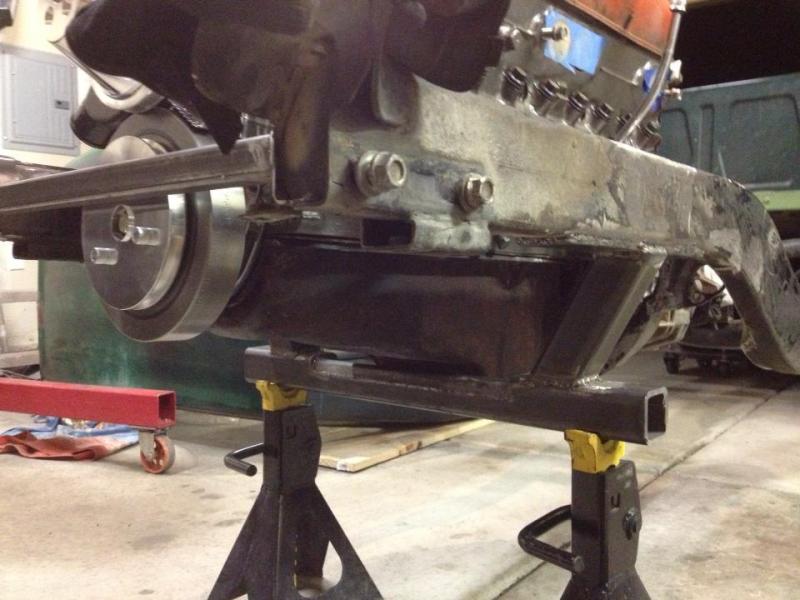

    Pulled the front suspension off and started cutting off all the old bits.
    Attachment 4625
    I could really go for a cutting torch right about now. Took 4 hours to cut the one side off with a cutting wheel. Not looking forward to the other side.

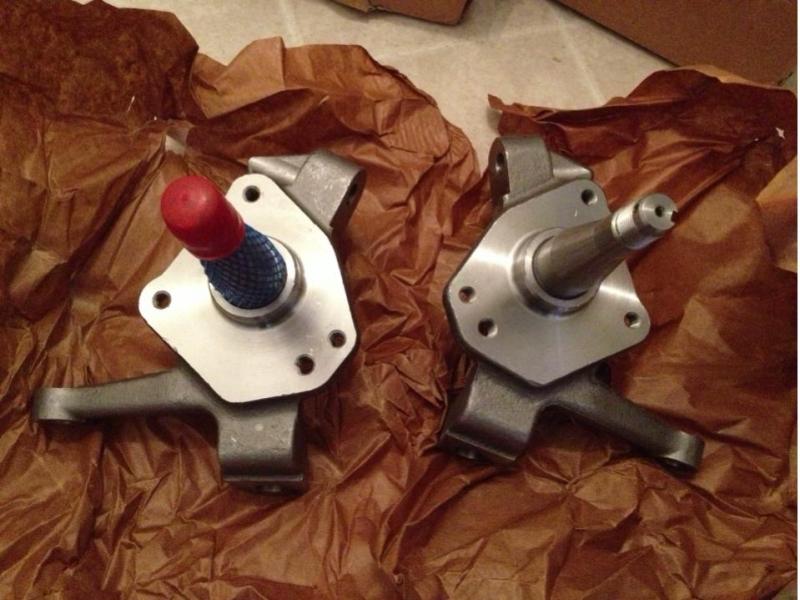

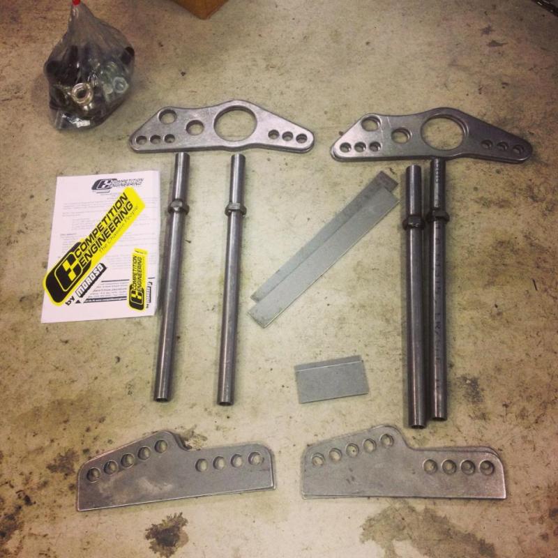

    Sawsall didn't quite do it, but with the cutting wheels and the saw, finally got around to cutting the other tower off last weekend. Had to set the engine back on so I could loan someone my hoist. In return, I'm getting a 15 circuit(iirc) harness for the truck. One less thing not to have to worry about later.
    Still waiting on the control arms to come in, but I got the 2" drop spindles and the parallel 4 link.

    ^^ not a bad deal for loaning someone da hoist.. btw, how much ur pair of spindles run 4?
    12-15-2012
    73
    New Mexico
    1978 Dodge D-50
    Chevy V8
    The spindles were around $150 iirc.
    The latest news, I received the billet single v-belt pulleys, mustang II upper and lower arms, and steering rack. I also went down to Choice Steel and picked up 10' of 2x2x1/8" square tube and 10' of 2x1/8" flat stalk. The cross member is done, now I need to make the mounts for the upper arms and shocks.
