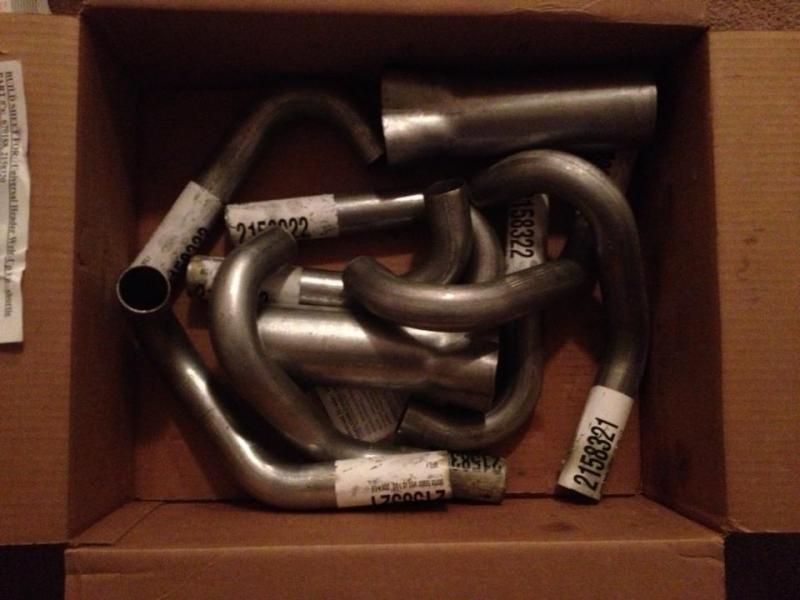

    Parts update.
    Short water pump, 160 thermostat, hv oil pump, oil pickup, hardened drive and header weld up kit (thanks 4cylinders).
    All that's left is a carb, distributor and random small pieces (hoses, brackets...)

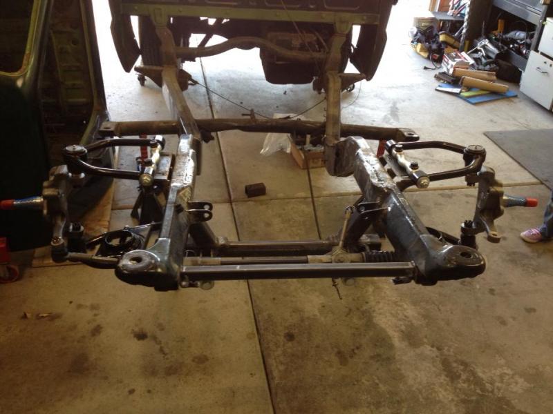

    Pulled the front suspension off and started cutting off all the old bits.
    Attachment 4625
    I could really go for a cutting torch right about now. Took 4 hours to cut the one side off with a cutting wheel. Not looking forward to the other side.
    Attachment 4626

    Sawsall didn't quite do it, but with the cutting wheels and the saw, finally got around to cutting the other tower off last weekend. Had to set the engine back on so I could loan someone my hoist. In return, I'm getting a 15 circuit(iirc) harness for the truck. One less thing not to have to worry about later.

    The latest news, I received the billet single v-belt pulleys, mustang II upper and lower arms, and steering rack. I also went down to Choice Steel and picked up 10' of 2x2x1/8" square tube and 10' of 2x1/8" flat stalk. The cross member is done, now I need to make the mounts for the upper arms and shocks.

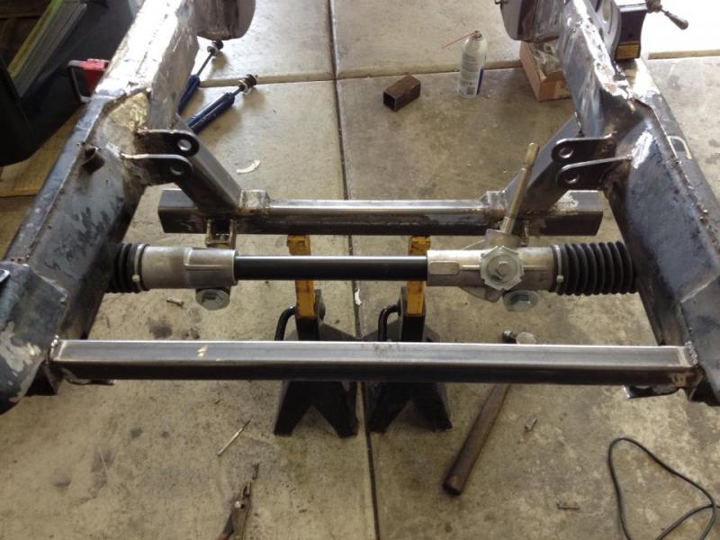

    Got the steering rack mounted today.
    Both my grinders died on me today, so I didn't get to finish making the brackets for the upper control arms. Going to run to HF tomorrow so I can hopefully get the arms mounted before I get back to work monday.

    Today, went to harbor freight and bought a cheap grinder so I could finish.
    Got the arms mocked up. Still a bit of welding to do, but it's great to finally see everything in place.

    ^ good progress so far man.. keep it up. what yr./model PS rack is that from?
  25. #50
    12-15-2012
    73
    New Mexico
    1978 Dodge D-50
    Chevy V8
    It's a typical OE style mustang II rack.
