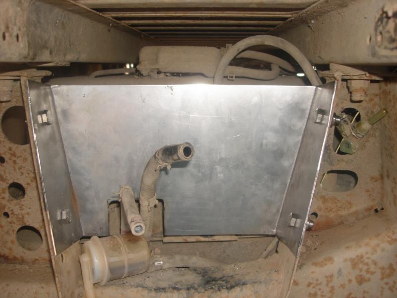

    DSC09747.jpg This is what it looks like all bolted in.
    DSC09751.jpg This was my original plan to reuse stock fuel filter, my mistake here was i did not pay attention ( guess i was too broke) to the forum posts saying ( When upgrading your fuel pump to a higher flow you should also upgrade your fuel filter. ) So after reading this i upgraded the fuel filter, which inter changed my fuel pump location actually making for a cleaner build.

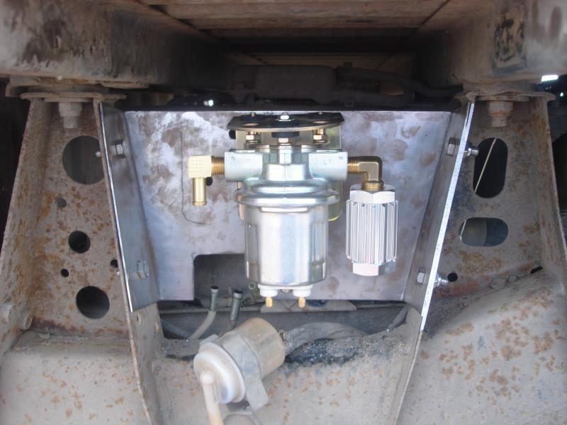

    DSC09975.jpgSo after redrilling the holes for fuel pump loaction, and checking the fit and adjusting the fuel elbows so the filter is also as plumb as i could get it. This is what it looks like.
    From here i removed everything clean bracket and bed brackets sprayed them down rust converter, i used Dupli Color Rust Fix two coats. Then i used Marhyde rubberized under coating both sides of bracket and inside of bed brackets.
    DSC00005.jpg Here is the final finished product. The fuel return line i hooked it back up and ran it behind the bracket and plug it off in engine bay side. This pic also shows it fully wired in with a relay, i will take some pics of that set up as well and post later. Since i did not take any at time of install.
    The only thing left i will eventually make a shield for this, not some much for dirt and grime just rocks or something else might decide to say hey "lets fly up there and beat that thing up" Still working on design as well.

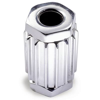

    Here is the fuel filter i went with:
    pfs-10211_w.jpg In line Street series by Professional Products Model # 10211; 3/8 NPT both ends, 2.4 inches long, 35 micron, rated for 160 gph @ 7 psi. this should clean up the build a little more and allow me to center the pump. I will hard plumb this to the pump and use hose from tank to filter.
    Got is from Summit Racing
