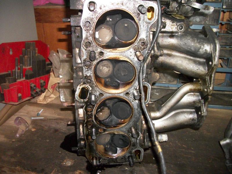

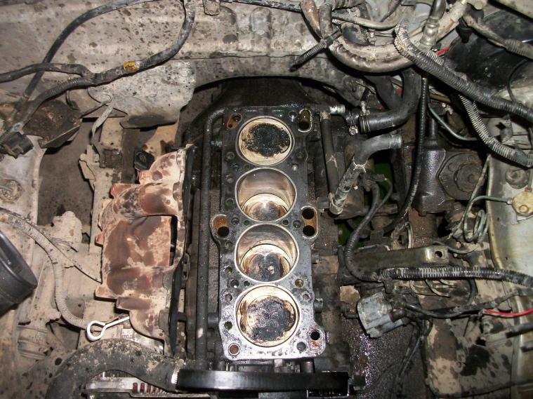

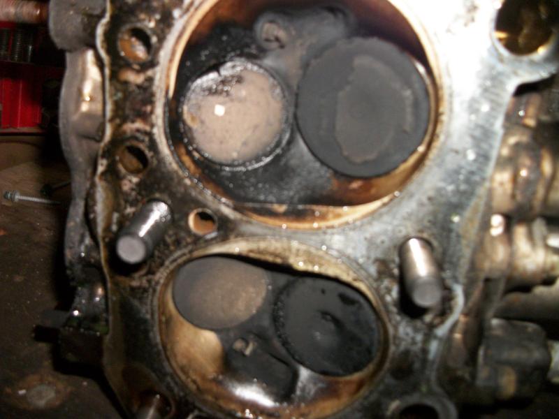

    So tonight i was coming home after my friends and I sat in my pickup waiting for a guy to come out and show us his 1994 4x4 V6 Mighty Max, we sat for a good 30-45 minutes, with the truck running and the heater going. The guy showed us his truck and after that I left, I had a pretty nasty cloud of blue smoke behind me and when I got closer to home my truck started to miss on another cylinder, I was going 35 and downshifted to 3rd, then 2nd and finally came home in 1st just wide open barely moving, I parked and foored it to see if I could clear it out any, nope, it sat at about 3 1/2k RPM and then I started to notice I could see the ground like I had neon underglow, so I shut it down and checked and sure enough from the cat back it was all glowing orange, so I let it cool and started the truck again, it didn't want to accelerate and it still was missing at WOT and only hitting 3 1/2k RPM, so I let off the gas a little and it was like a magic little switch that fixed everything, the engine hit 6 1/2k RPM and I let off, I revved it to 5 1/2k RPM and then I got this hellatious knock out of no where, so I drove it in the garage and I could feel the knock through the shifter but the engine was barelly rocking, unlike when I threw a rod in my 87 where when it did run on 3 cylinders it shook like a no other.
    So I pulled the head and found that cyl 3 defiantly had a burn exhaust valve, I turned the engine by hand and still heard the clunking noise, but did not see any play at all in the pistons, but when I jumped the starter solenoid it just cranked over, no clunking or banging at all, but I let off and it started clunking. I have a feeling that the whole reason the exhaust was glowing orange is the fact that cyl 3 was just pushing unburnt fuel/air into the exhaust, and when I drove off all hell broke loose when cyl 3 started to hit, I think my clunking is somewhere near the flywheel, like I destroyed the pressure plate or if at all possible, the ring gear came unattached from the flywheel.
