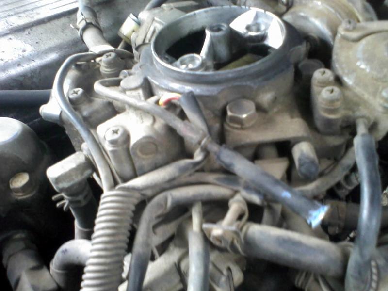

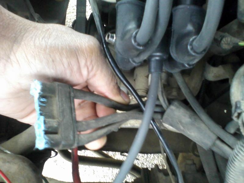

    I took 3 pictures of some of the issues I see under the hood.
    1 of the pictures, you see the Big Blue connect by the battery. On end the 2 wires are cut..not sure where they go. I tied them in and put them on the positive battery post. Not sure if that is correct or not.
    In another pictures, there is a black connector with 3 vacuum lines attached to it that have been plugged off with blue silicone. I am sure it went somewhere, but not sure.
    In the last picture, there is a vacuum line coming off the carb and it has been plugged off too! Not sure where that line is originally suppose to go.

    All of the plugs by tye battery are supposed to be connected to the battery. The second pic under the first intake runner or around there there is a sensor that those three vaccum lines go to.

    Thanks for the assistance with the hoses. I put a new valve cover gasket on yesterday and it ran a little better. I unplugged the lines and put them in place, now it is running like it is missing again. I still have the smoke though. I don't know what to do. There is one more line that is plugged and it is the one coming off of the carburetor in the 3rd picture. Im not sure where it goes. Then under the carburetor pan, there is a empty nipple something goes there, not sure what line though.

    this picture shows the lines that should connect to a TVS in the water jacket on the manifold. It would normally be with in reach of the lines. As for the EGR if it was stuck open. it will cause a vacuum leek and it will run like crap. Have you pulled the O2 sensor to see what it looks like? These feed back carbs are crap. If you don't have SMOG then I suggest swapping to a Weber. Also try plugging off the PCV valve hose. See how it runs then. Re torque all the intake bolts. Also if you have the box on the fender with 10,000 vacuum lines running in it. They like to crack in there. I'm still concerned about the white smoke being a head gasket. With the radiator full to the top and the cap off. If you start the truck does water shoot out like after a hard night of drinking? Or does it just sit there like a good dog? Also can you get us a overall picture of the engine area, so we can see if there is somthing we might be overlooking.

    I did unplug the hose from the pvc and it smooth out pretty good. I cleaned the pvc and put it back and all was good. Hopefully cleaning this EGR will work. I just got a gasket for it as there wasn't one there. Look at the 3rd picture in my previous post. Can you tell me where that vacuum line off the top of the carb goes? My is plugged/capped off.

    I want to say that one curved right back to the carb it's self. I increased the size of the diagrams for you above.
