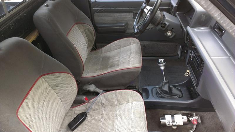

    Ill go ahead and contribute. 2000 Hyundai Tiburon seats I installed in the 90' MM 4x4. I had to remove the Hyundai rails and welded them to MM 4x4 bucket seat rails. Nice low profile, snug seat that is quite comfortable.

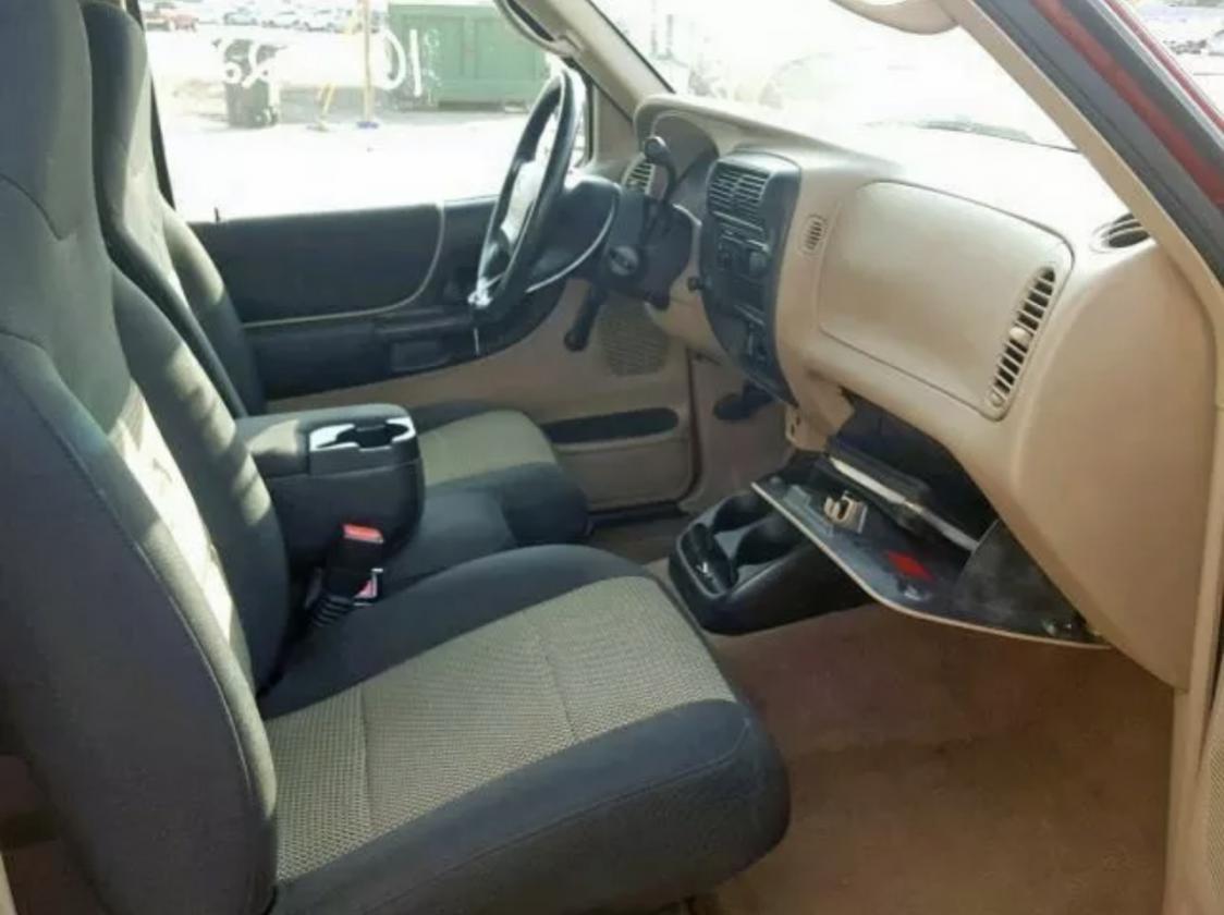

    Anybody ever try (or think to try) the ford Ranger 60/40 split bench as a seat swap? They are super easy to find and It has a flip down armrest with cup holder in the middle and some storage! Plus it counts as a middle seat if I need to stick my daughter in there with me! I’m sure there would be some fabrication involved but was just wondering!
