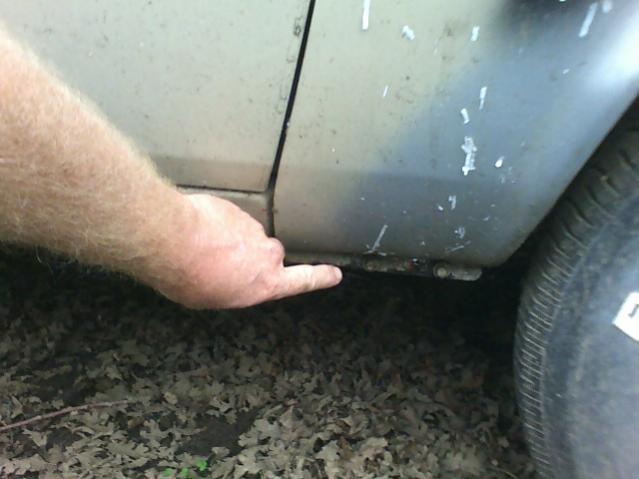

    First go get the windshield resealed. DO NOT USE SILICONE. Then on each side of the truck under the rounded cab area find the 2 bolts. (see picture) Now there going to snap off. Thats just life but it's not a problem. (optional part) { Remove them along with 1 or two inside the splash area. Try not to break them. You will want to reuse them later. } Now gently,,, and I'm talking gently,,, (it's only a beer can for Gods sake) pull the fender away from the cab. Stuff a peace of wood or screw driver handle in there. Stick a long and I mean long screw driver / metal rod or something up there. Now remove the 30 years of dead leaves, grass, mice, skunk meat, and other nasty crap that has built up in there over the past 30 years. (NOTE:) You will see a small bump out area between the bolts at the bottom. That is all they give you for a drain. So it doesn't take much to plug up. Just like the bed drains in the back. But there large in comparison. Now you can take the hose and flow water down the vent in front of the windshield and flush out the last of the crap. Finally replace the bolts. But if they snapped, and I bet they did, just whip out the cordless drill. Now use a 1/4 inch bit and drill the holes out. Now through bolt it with 1/4 20 bolts. This way the next time you have it cleaned out 30 years later someone else can replace them with out having to find metric bolts. Your done. Or at least you have slowed down the flood.
