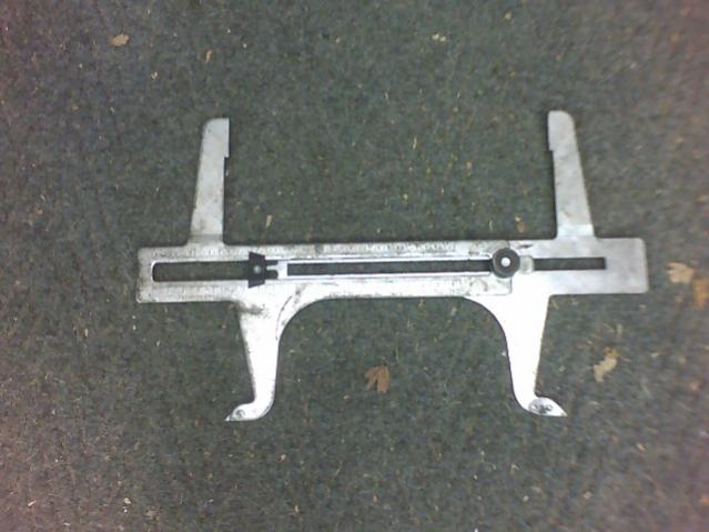

    If so the rear need to be adjusted up. You would need to pull the drum and use a safe set tool to adjust it. This will get it close to where the adjuster can keep up. Pep Boys will loan them for free.

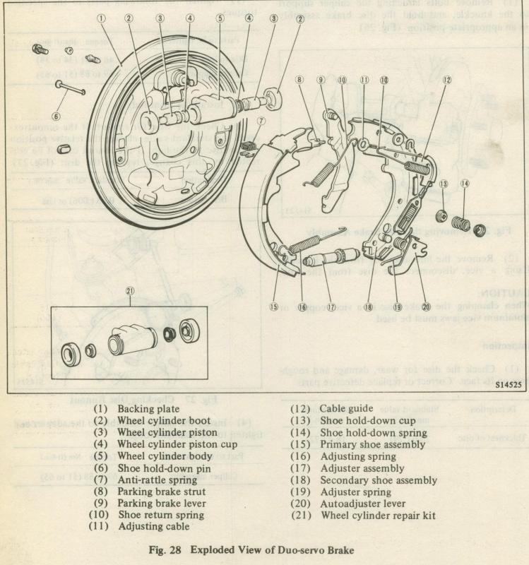

    That could be somthing to do with the parking brake lever and the cross bar. Lets say you push the pedal. The piston starts to move 1 shoes, because the other is held away from one side of the piston just a little bit because the show is catching on the edge of the parking brake cross bar. Then when things move "Just enough" the spring tensions snap the other shoe off the cross rod and onto the piston face. CLICK, that forces both springs to have equal tension from each spring realignment them back to center. All this happens with in 3/16 of an inch movement inside the drum..... . Thats one idea,,,,,
