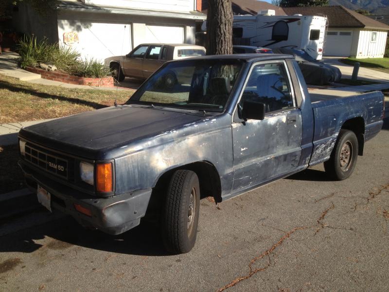

    This is a build thread for my '88 Dodge Ram 50. I purchased this truck for dirt cheap and figure it will be a good 3-4 year project to accomplish what I have in mind for it.
    What I've done since the purchase date of 10/28/12...
    Removed the damaged tailgate which was jammed in the closed position for a number of years according to previous owner
    Registration + Insurance
    Replaced wiper arms (found at junk yard)
    Replaced passenger seat belt receiver buckle (found at junk yard)
    New wiper blades
    Oil/filter change... looked as though it hadn't been changed in over a year
    Replaced the air filter
    Replaced drive belt
    Topped off brake fluid
    current to do list...
    Clean carburetor
    Replace valve cover gasket and grommets
    Clean up engine bay
    Bleed brake line
    Check for any other leaks
    I have been driving it around town. Longest trip so far was 40+ miles one way (mostly freeway). I've gotten to know this truck pretty well over the last month. It's been talking to me and I'm enjoying the bonding time. It still has a little hick up, periodically, between 70-75 mph. It was worse prior to the Oil/filter/air filter change. Hoping cleaning the carb will rid of it.

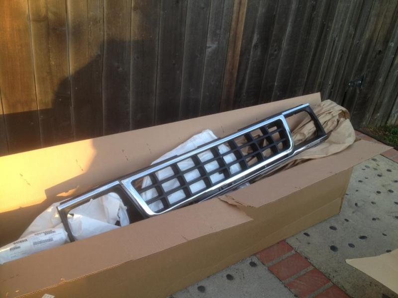

    First new part... 90-92 Mighty Max chrome grille

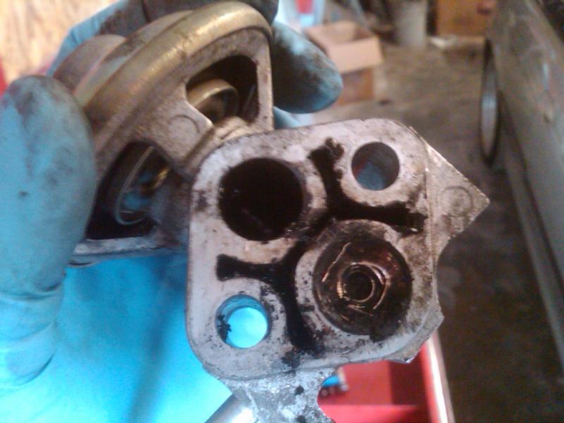

    check ur EGR valve and passages. i took mine apart today and look... hella nasty!

    How'd you go about cleaning that ikeepz? As soon as I get a new gasket I'm doing that exact thing. Guaranteed gunkified EGR.

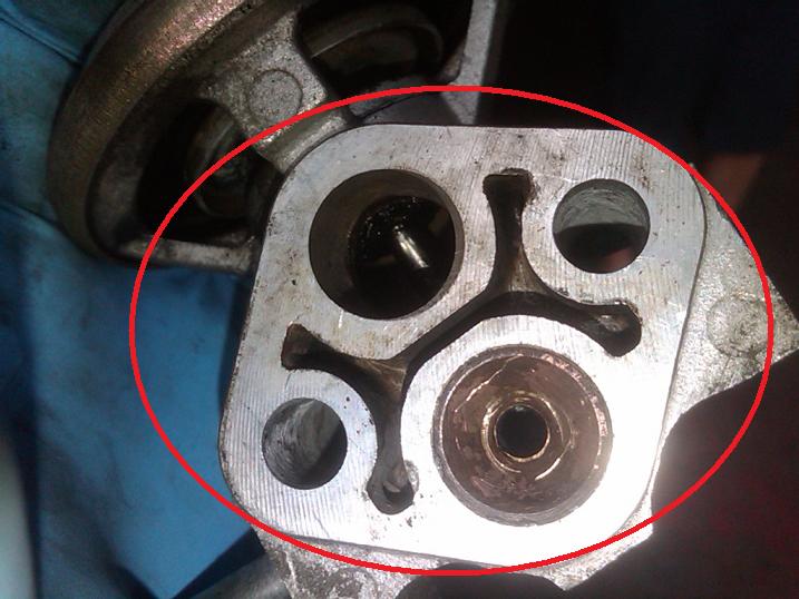

    Quote Originally Posted by dondelusion View Post
    carb. or brake cleaner, then soaked the bottom part of it (circled in red below) in Purple Power overnight.. and finally a polish drill bit after it dried up, then aluminum paint.. i need to tk a pic of da finished product
    if you can't dodge it, Ram it!
