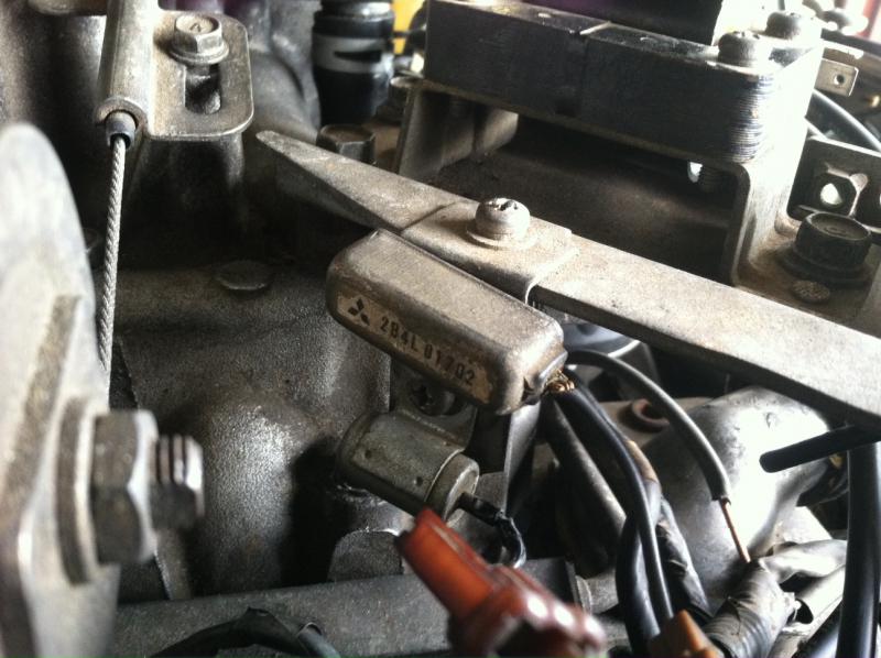

    photo.jpg Does anyone know what the part in this pic ( with the part number on it ) is? I've googledthe number and found nothing. I'll try and get it fromthe Mitsubishi dealer if nobody knows. Thanks...

    Looks like a resistor of some kind. Not sure. A regular test light won't work. It draws to much current. You could use a an analog meter. Then you can see the needle swing.
