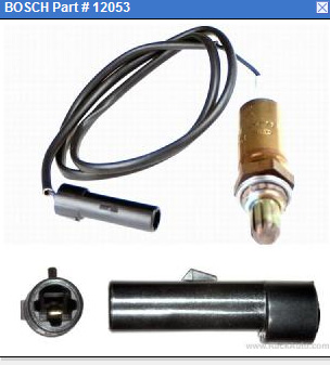

    I have a 1987 Dodge Ram 50 California emissions model. It has the check EGR light on. I have replaced the EGR valve. I have switched the switch in the dash to the right and back to the left. When it is in the right position the light turns off. Soon as I switch it back to the left, the Check EGR idiot light comes back on.
    I have examined the O2 sensor and it is missing. It appears that one of the previous owners removed the O2 sensor and replaced it with a spark plug. I do not see the wire for the o2 sensor even if I installed an O2 sensor which is missing. Any idea what kind of connector/wire I should use to connect the O2 sensor? Any idea where it connects? A picture would be great.

    Well that's a first.. A spark plug. If you pick up a new O2 sensor then you will have an idea what to look for. It's got to be over there some where near the right fender. It should look somthing like this.

    Thanks for the picture of an O2 sensor. Unfortunately that is not my problem. I can see the location where the O2 Sensor screws into manifold. My problem is I do not know where the electrical connection goes from the O2 sensor.
    In other words, the O2 sensor screws into the manifold, but where does the other end, specifically the electrical end connect? Since the previous owner removed the o2 sensor I do not know where it goes.

    You need to look at the wiring harness on the fender. There should be a plug that looks like the one in the picture. Within a foot or so of the hole the spark plug is in. Also if you look through the manuals we should have a wiring schematic with color codes. If he just cut the plug off then you need to look for 2 wires. I guess there taped if your lucky. Ya never know what someone did. It's just a bug puzzle, with all blue peaces.

    The Pix is for locating the Timing Plug (red Circle)but it shows the o2 sensor also.
