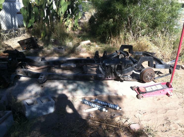

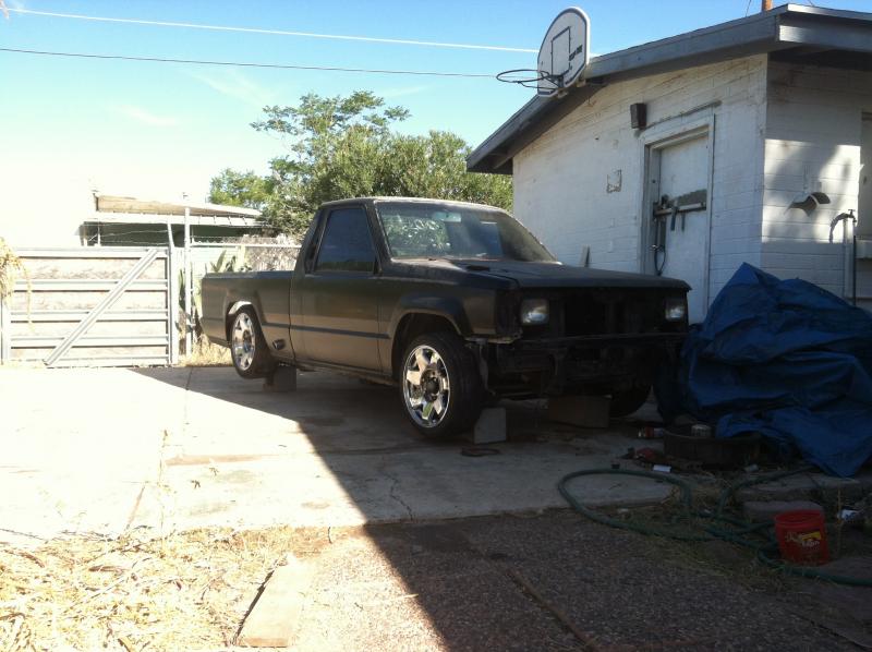

    Here is the frame I'm gonna build and the 88 d50 that will be getting frame someday.
    If they are the same wheelbase, they should interchange without problems. Since both are carb motor frames, the fuel lines and such are also the same. The only difference I could see causing a problem is if the one truck was a standard cab long bed and the other was an extended cab short bed - the wheelbase is the same, but the bed and body mounts would be in different places.
