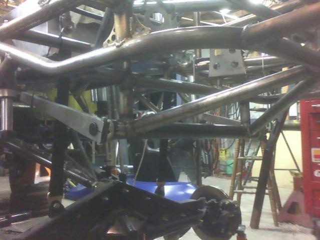

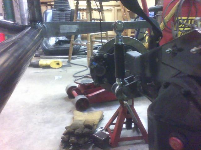

    If your just looking for a sway bar you can get them any length you want. You can also get them with bent arms to allow for tires. This is where mine came from. I just used a rod to connect them after cutting off the first 8 inch or so of the arms. I was forced to put them on the rear this time, there was not enough room up front. I used a peace of DOM tubing to hold it in place. It was about 180 bucks after the machine shop and parts. Wasn't to bad.
    http://www.1speedway.com/Swaybars.htm
