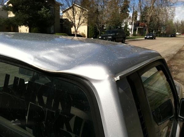

    I am going to go pick this up on Wednesday, I have my truck sold to a friend of mine for $550, unless he wants the Pioneer deck that is in it, then it is $600. How do i get that dent out of the roof?
