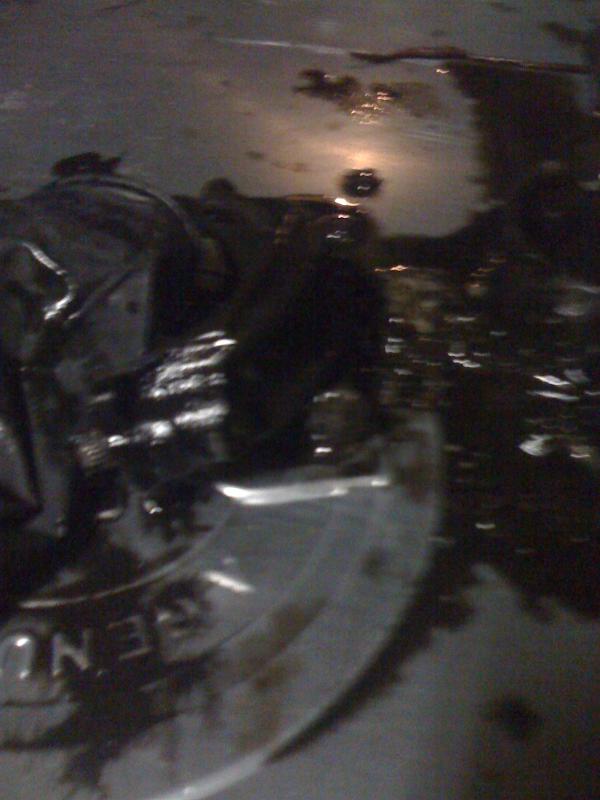

    Okay. Well I installed a waterpipe I modified to work for my application. Bought ne hose clamps, coolant and dropped it in yesturday. I started it and it ran fine, for about 5 or 6 seconds. Then it died. I'll update when I pull the head off again. So far spark plugs 1 and 3 exploded, I see a valve upsidedown and a piece of my spark plug logded in piston 3.
    Unhappy
    WTH ; how did that all happen in 5 or 6 seconds?!? You running nitromethane in that or what? Something wasn't right somewhere...:o
    Was the head shaved or block decked - sounds like major piston - head contact...
