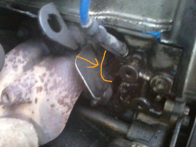

    also looks like i may need to do a helicoil. the surrounding of the #1 plug is soaked in fuel i think. would that mean id have to do a helicoil? could that be the cause bad compression?
    also i think the owner before me had advanced the timing to compensate for the bad vacuum advance.
    im reading in the manual on timing but im not seeing what im looking for. is there a indicator like on a small block chevy that shows where your timing is with a timing light?

    heres a pic of num1
    06-21-2011
    107
    Monticello, IN
    not very good but i will get a better one tomorrow during the day.

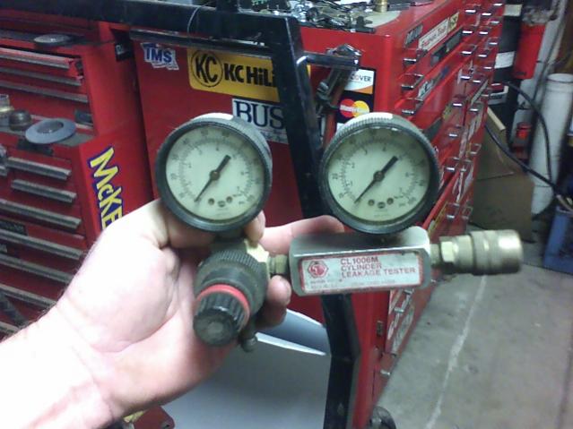

    Here is a CLT tester.

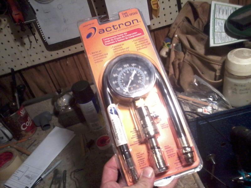

    this is the one i have

    heres a slight better pic of num 1
